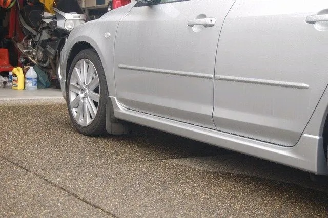

nnrich57 said:
I haven't done this myself so you would know better than I if this would work, but what I was thinking is to put a hole in the end of the "plastic" sill then use one of your SS bolts, a washer on the back side (fender washer if it would fit,) and a SS nut. You'd have to detach the flap from the body after drilling the new hole, then attach the flap to the sill first, then reattach the sill and the other two bolts.
Food for thought if you start having problems w/the current set up.
Thats a good idea, I even think that the bottom of the sill is just hanging there (no metal frame behind it), but I could be mistaken. I haven't checked it yet. If that is the case it would be easy to drill a hole, bolt it with SS and just put a nice washer w/nut from behind.
I am goin to check that out as soon as I get home.
The sill clips (plastic, so be careful) in after the harware on the end is loosened... I believe the same hardware you are hold the flap on with, iirc.

OK, you can kill me now if you want to, and I DO applaud the effort, but if I were you I might've done something a little more like this:
This, of course, assumes that you had cut off that much from the top. But I think your concerns are correct. There may not be enough support there to stand up to higher speeds, or heavy slush and snow.
I'd at least try to add some support (see the extra screw) @ the bottom.
Other than these concerns, which mirror yours, I think they look good... for mudflaps.

I was ALWAYS against it, but changed my mind after the install, itactually looks quite decent. It keeps the slush/snow/STONES off the doors and sills.
They are easy to take off, and I might just take them off for the summer season.

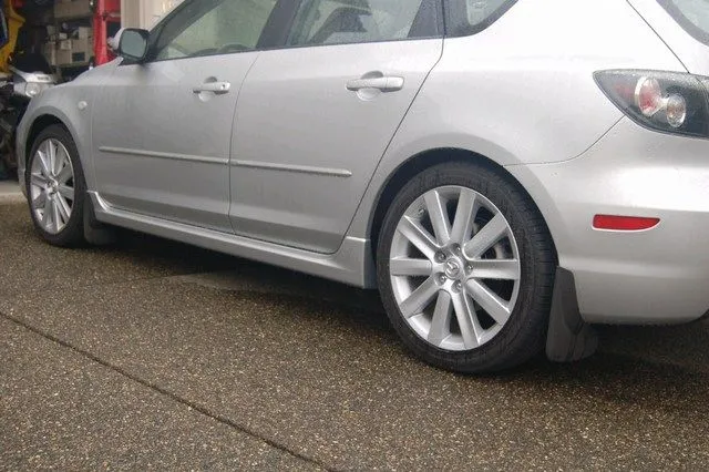

I agree they're not the nicest looking things to add on, but it sure goes a long way in saving the paint. I put mine on when I had only ~150 miles on the car, and the lower trailing edges of the sills were already pitted. Of course, they use gravel out here instead of salt, but still.
Here are some pics of the Autozone mudflaps; they actually fit pretty well. As mentioned before, I cut out some Scotch clearbra material to serve as a backing under the mudflaps. When the car is clean, the clearbra is nearly invisible. When it's dirty, well, it's dirty.....

You can barely tell they are there on my black mica, I only have the front on and they are trimmed down.
