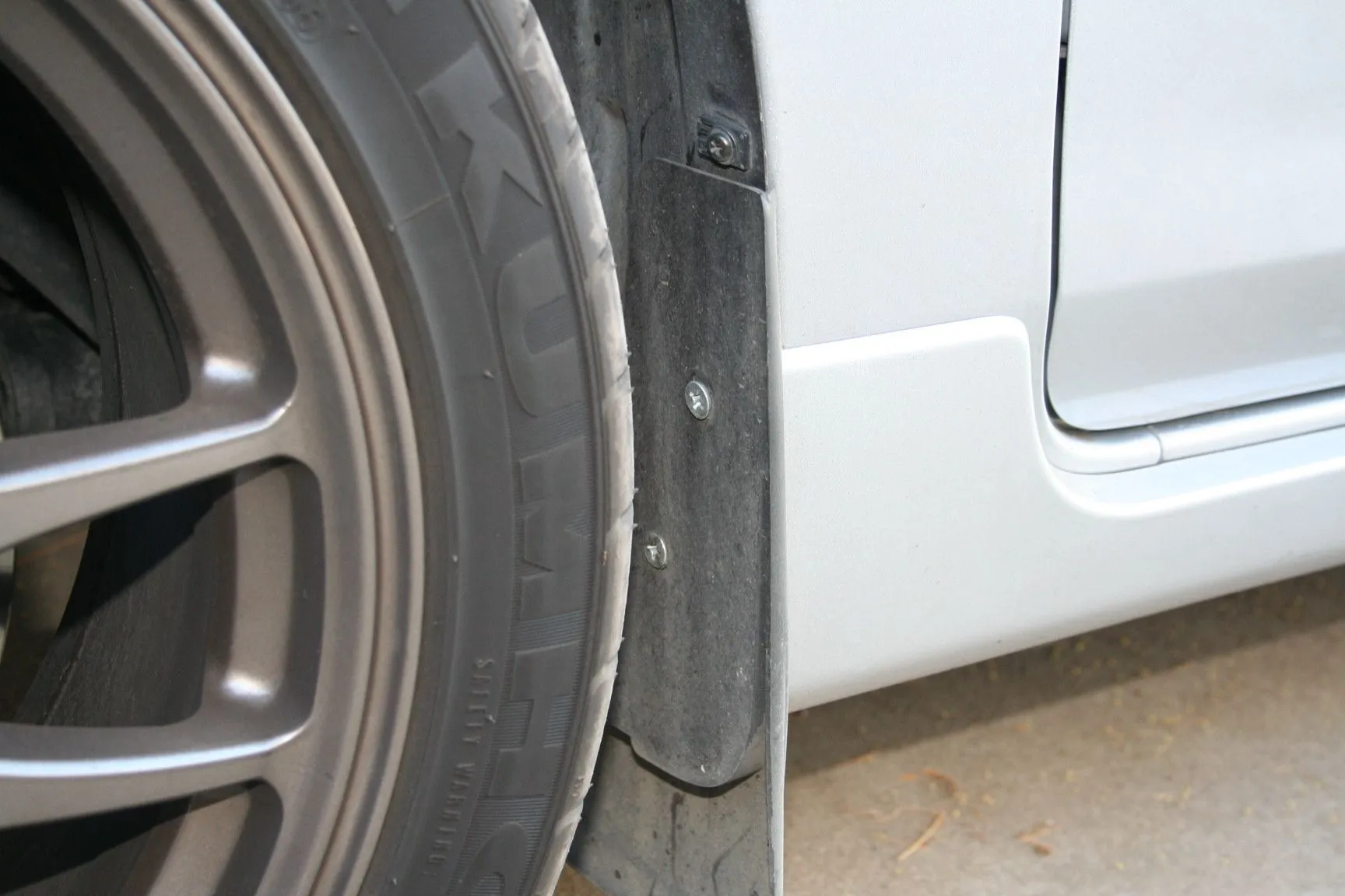

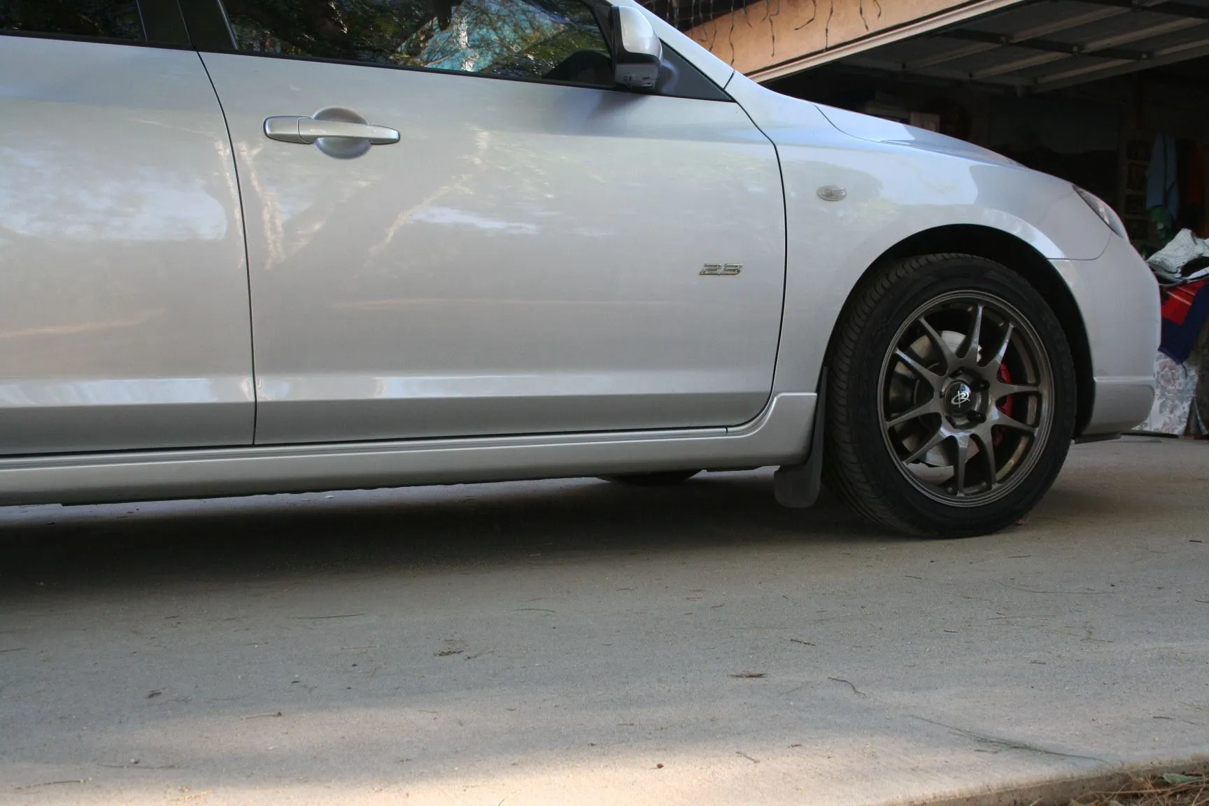

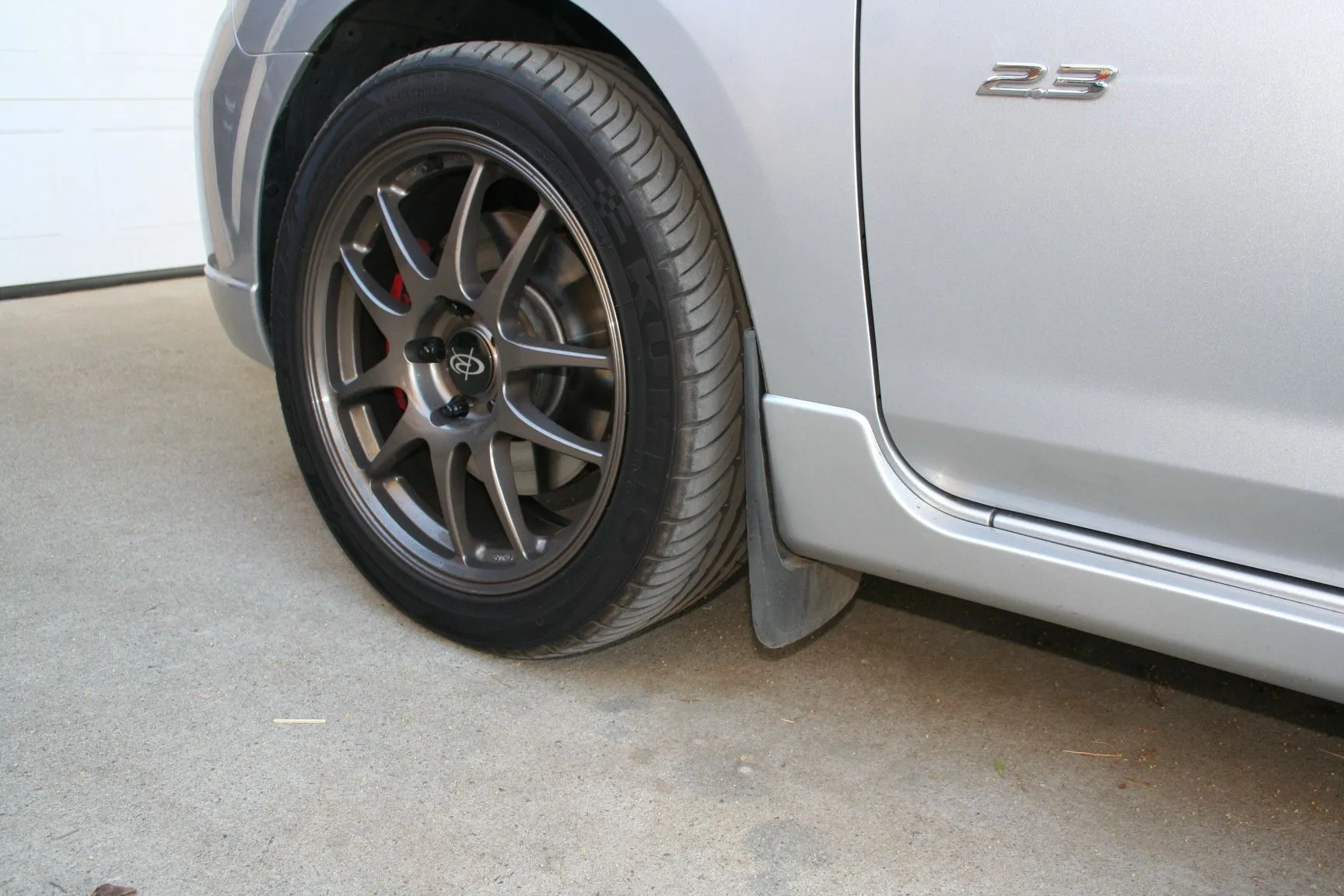

Yeah I do, sorry bout the first one, only pic I had on me. Took some this morning for ya.

Thanks for the pics. Not very noticable at all.
Does it help in the winter to keep the slush and all that crap off the doors?
So far its keeping alot of the salt from the mtns off my doors, as well as the black grime after the past bit of rain this weekend as well. I took them off the other day and my car looked naked.

Sorry for the beginner's question...how are these mounted? I see the screws, what type are they and do they go into sheet metal or what? I assume you took the wheels off to do this.
Probably only into the plastic of the side-sills. Obviously taper-headed, self-tapping screws. I might've used pan-heads instead. And you should be able to do this mod by just cranking the wheels to one side or the other.

They are "power flow pro fit splash guards" Its a red\white\silver box and it has a large one on the top left corner. There are 3 types and just from eyeballing it the 1 was the one that would fit the best. I trimmed the moulding on the side that sits on the side sill. The little bit of rubber caught debris and will scratch the sh*t out of your paint, so cut it off.
I just used some bolts, regular flat tipped bolts that had a tapered head and fit into the plastic retaining clip I guess you could call it.
The clip im talking about has wings that expand when you screw the plastic screw into, much like what holds the plastic wheel well covers in place.
There is absolutely no drilling into the side sills or anything, it just goes into a factory hole that is totally reversable, if you dont lose the plastic screw that goes in there from the factory.
You just have to line everything up and drill holes into the splash guards. I left my wheels on and just turned them to the side, plenty of room to work.
