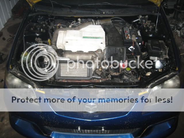

Bump. My Protege is now running with a KJ swap in front of an MX6 transmission. It's a PITA. I just got it running today. It's not making full power, as the ecu limits boost in first gear, and I'm thinking that's what's going on, I'm looking for suggestions on a way around it.
The hood has to be clearanced slightly, but it fits. Just the bracing. A CF hood would have no problem.
nice KJ there is a write on here and on several other sites on how to swap the kj into a p5 i haven't seen one in a MSP though
