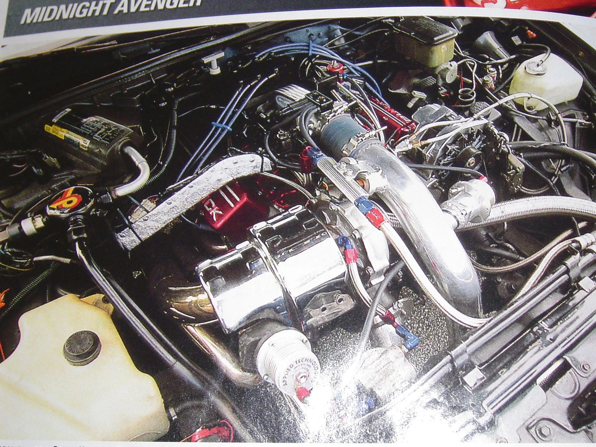

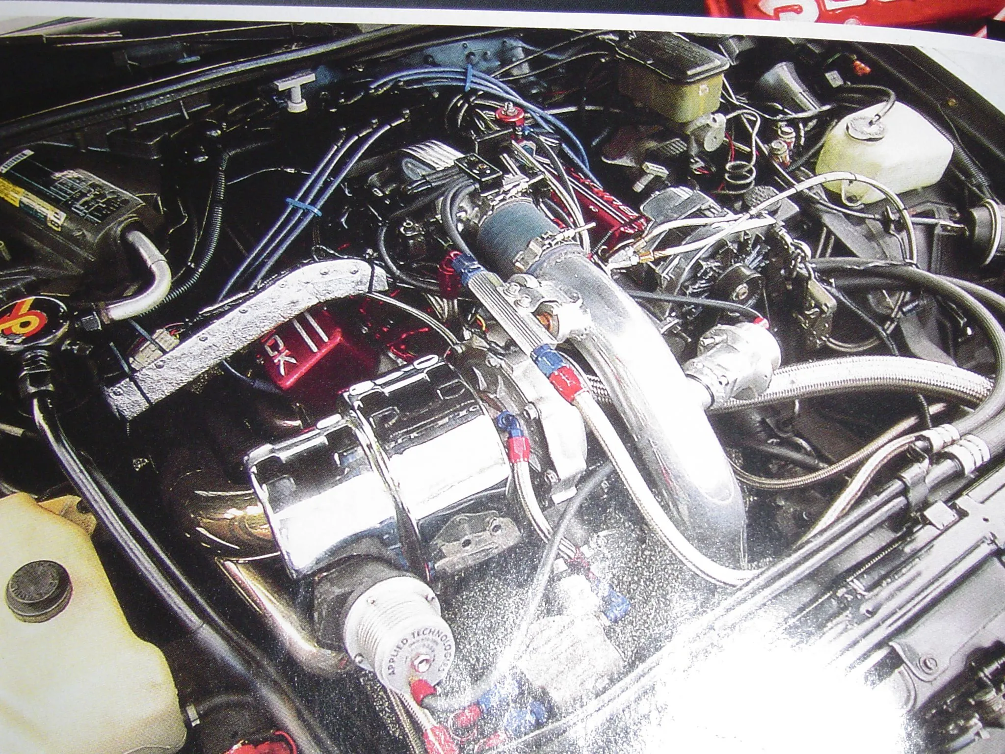

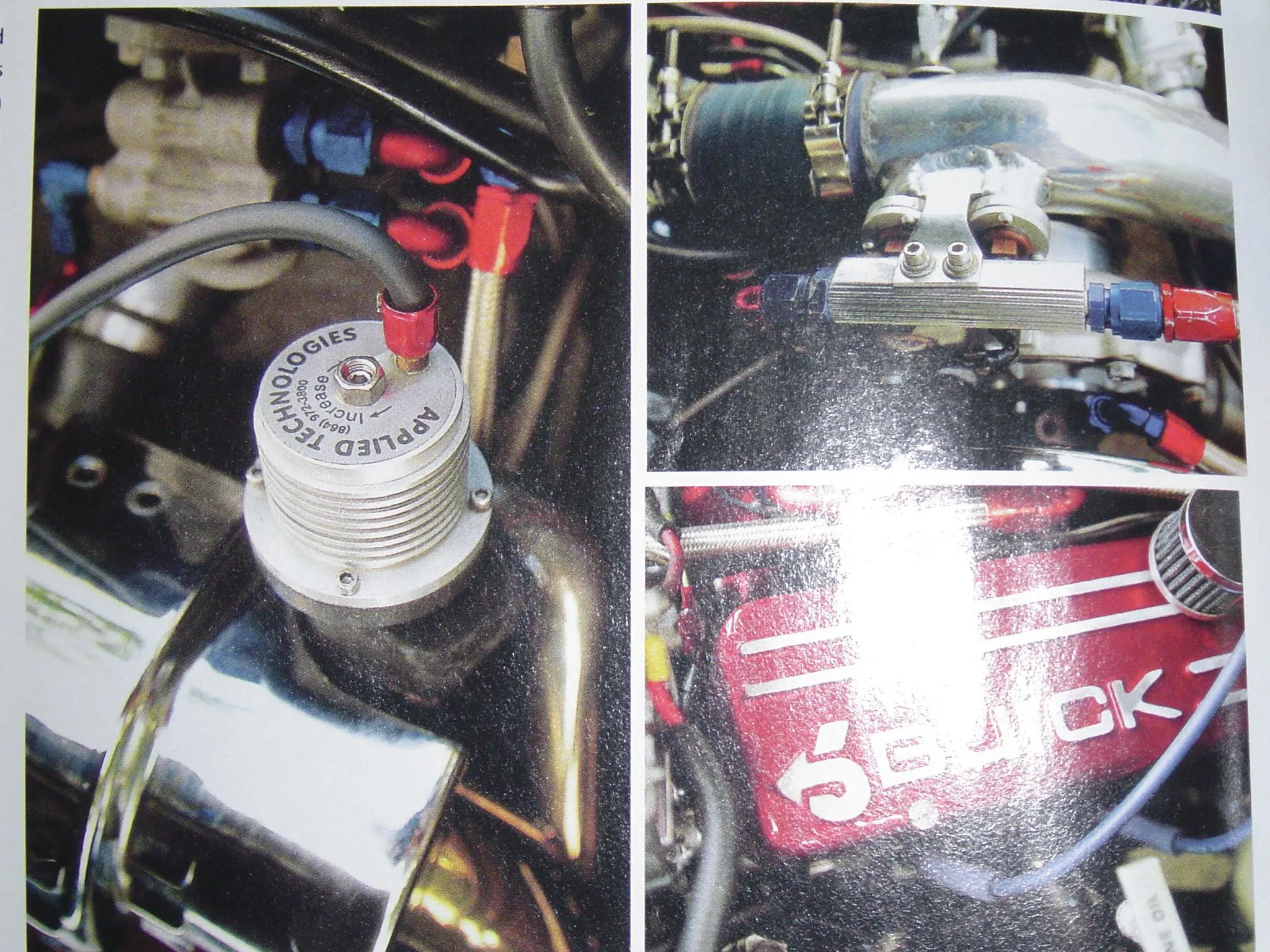

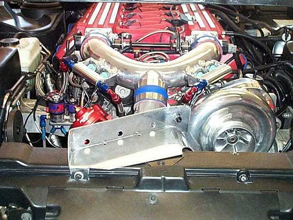

Here are some pics of a vehicle that negates this opinion. This vehicle is in the Feb. issue of turbo magazine an is running 34 PSI of boost WITH extra injectors and makes 780whp and runs the quarter in 9.83 seconds. And another picture of a turbo Viper using them, posted by MPNick. The viper has 10 cylinders, so if the injectors were crap, then it would reflect it more on this engine than ours because the fuel has to go farther to reach all the cylinders.(5 cylinders down, instead of 4) I'm sure that this viper guy wouldn't be putting cheap, non reliable things on his car when he probably already has over 50K in the motor already.
How do you know that the extra injector setup is not good for anything over 10PSI??? Have you tested this or is this an opinion. I wouldn't think that this guy would be able to make this much power at this boost level if the extra injectors gave an inconsistant A/F ratio between cylinders.
I'm not saying that that extra injectors in the IC piping are the only way to go, or that extra injectors in the manifold are not good. I am just trying to make a point that having them in the IC piping can and will allow your motor to produce good and reliable power. It is also a cheaper alternative to buying 4 injectors and then having someone drill your manifold to fit them. Our motors are no power monsters, so it will be okay to have them before the TB.
P.S. sorry for the light spot on the pics, I took pictures of the car in a magazine.
