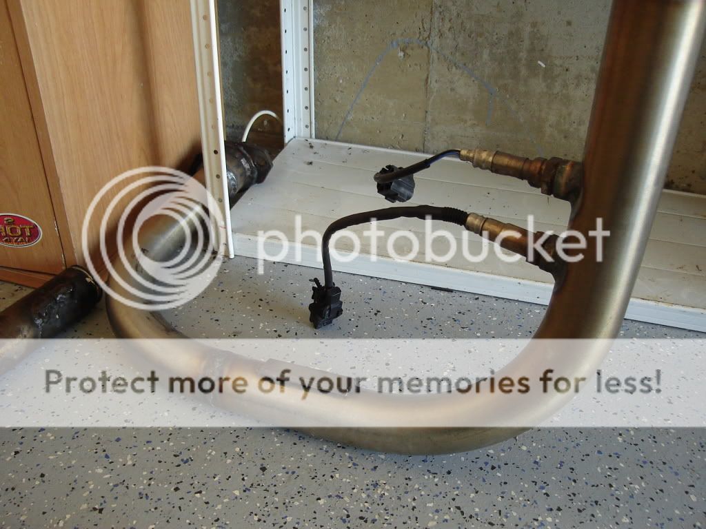

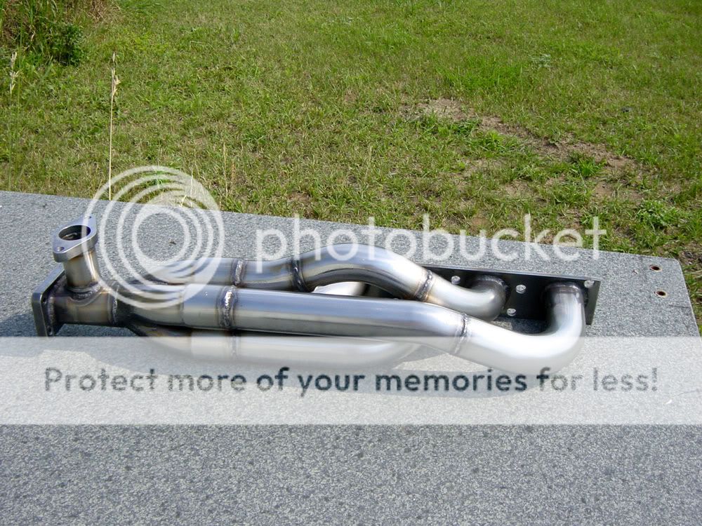

304 Stainless Manifold
GT28rs (GT3071 .63 Upgrade Spring 2012)

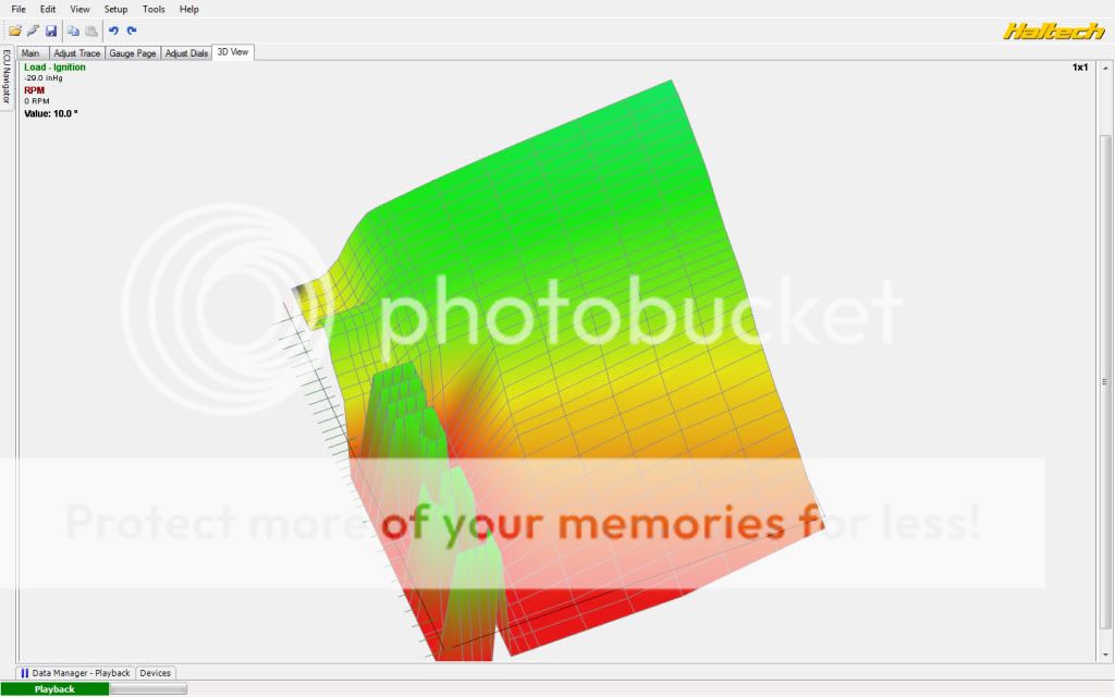

Full Control over Timing in 3D
Full Control over Fuel in 3D

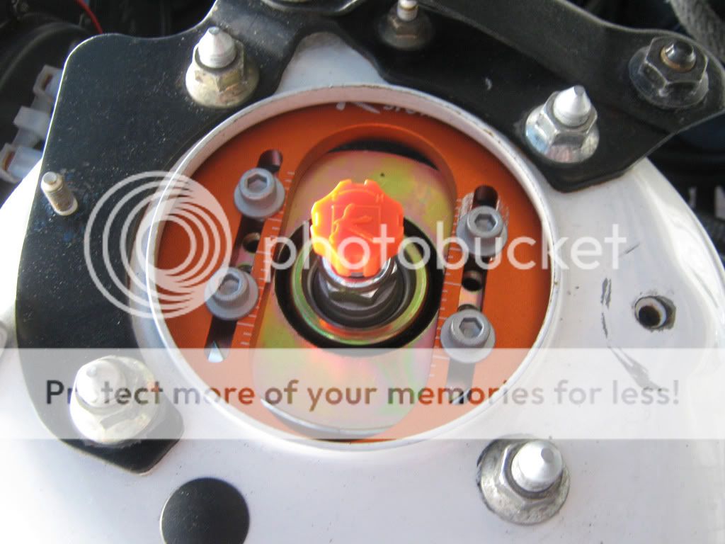

-K-Sport RR Aluminum Coil Over suspension

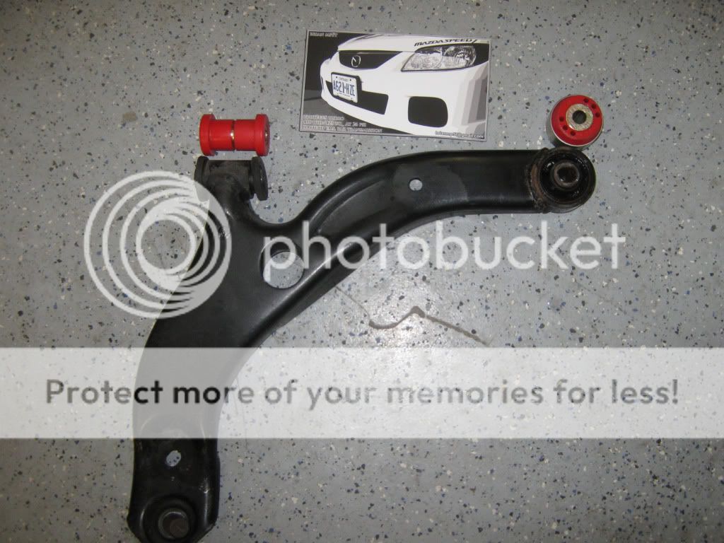

Peddler Poly U Bushings in Control arm

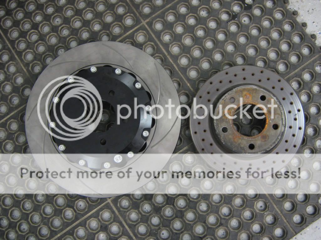

-K-Sport 14" 8 Piston Brake System (Front)

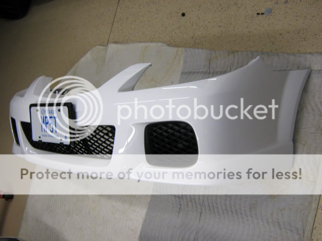

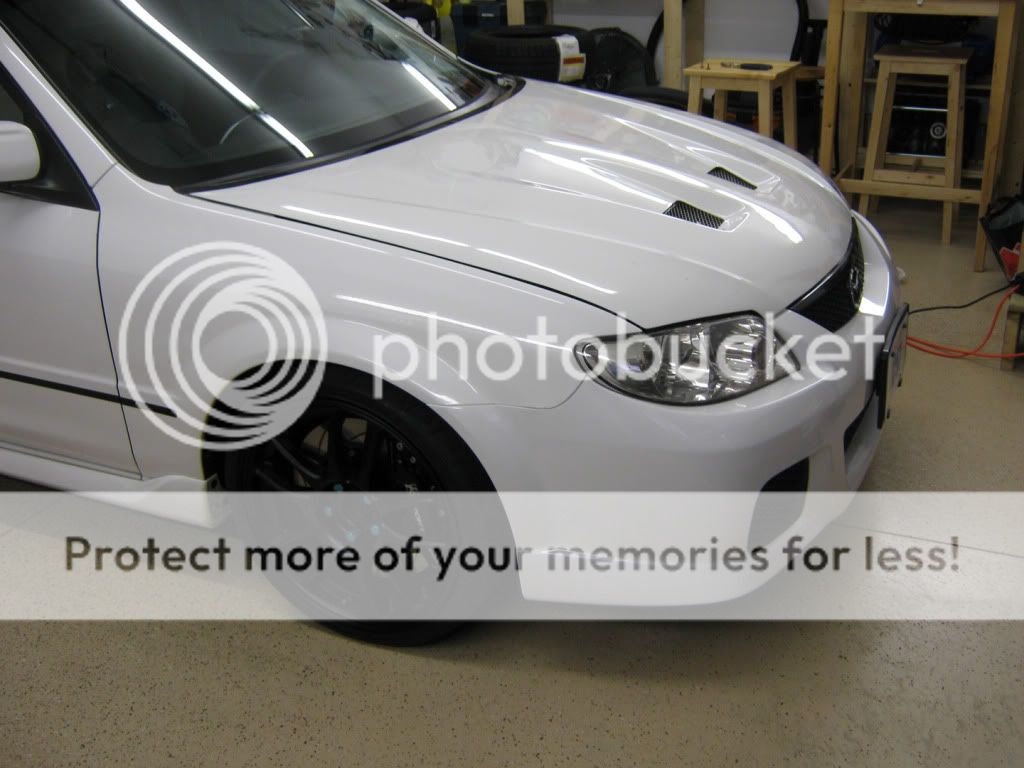

SPORT20 Front
SPORT20 Rear
SPORT20 Rear Lights
Black Headlights (Upgrade Spring 2012)

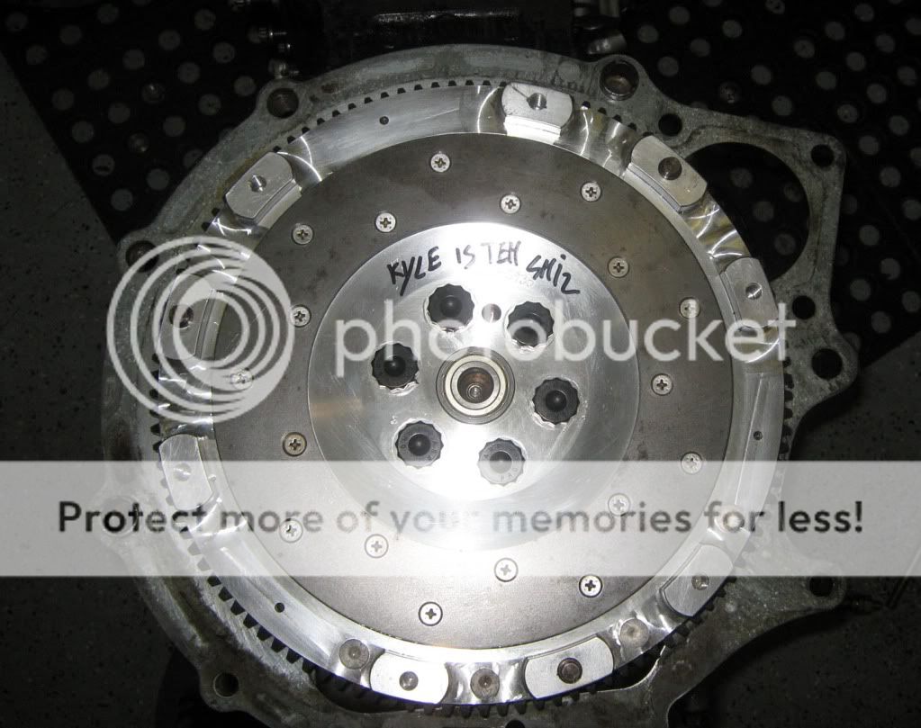

SPEC 6.8 Lb Flywheel

The Haltech knows what the engine operating temperature is and can control Digital Pulsed Outputs to a Solid state relay to control the speed of an electric motor.
The Haltech has a map with Coolant Temperature and Load as X and Y.. The Z (Output) is Duty Cycle for the pump.

As the power went up and up, the transmission was totally useless.. I broke two stock transmissions, so I decided to get PAR Gears. Now that I had so much more HP, I decided that the car could power taller gears.
I planned this originally to make the car more fun to drive, to lower the RPM at 70 MPH and to give the P5 better legs to run with. I was tired of punching the gas and being forced to shut down before 120 MPH... the car would go from 3000 to Redline so quickly that it was a bit anti-climatic.
This is where the idea of the Texas Mile came out... Rather than just making the 5th gear a little taller... I would make it A LOT taller. I spent 2 Months calculating gear ratios. I was worried that I would **** Up a ratio and the transmission wouldn't have a tuned balanced feel between gears... The Shiftpoints had to be dead on. I needed it to be able to deliver power on boost, without falling out of boost and without the need to redline every shift.

With Taller Gears, you get higher top speeds, those speeds are too great for the OEM brakes to stop effectively. That became apparent the day I put the car away for the winter last Fall. I had to make an emergency application and one disk warped and the other cracked. I spent the next winter overseas and in my spare time planning the next step (Spring 2011)
14" K-Sport Brakes, K-Sport Suspension to replace the Tein-SS, PAR Gears, Quaiffe ATB LSD, New Forged Motor, StageIII Clutch, 6.8 Lb Flywheel... Big Money planning.

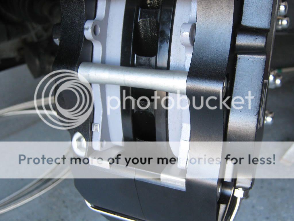

All of these so called Bolt on Parts were not. The Brakes required several weeks of trial and error. The brake lines ended up being made completely out of AN3 SS Lines. Neeed to install a hydraulic handbrake, installed a fuel system, it sucked so I remade the entire thing out of AN6 SS... You see, all of these trivial sounding things all added up to be 2 months of on/off work.
I noticed that the BBK was 2 Lbs heavier each side... I became interested in Forged Rims to replace the 28 Lb Enki CDR9 that I had. I found a set of WORK Emotion KAI rims for sale, Bought them.. They are Flat Black, This totally changed the look of the car... everything that was silver (Lines, Decals, Headlights, Tinting) had to go black. I also got my hands on all the exterior parts that would make the car a SPORT20 Conversion. They were in bad shape and needed to be refinished.
The new rims sit 2mm away from the new calipers. There is no place for weights so I had to come up with a way to balance them. I found a shop that would static balance the rims and I was finally on the road.

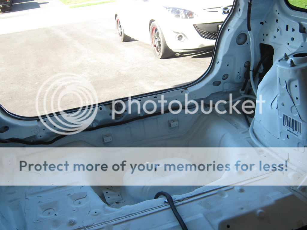

2. you showed the hole in your dash during the build, and it’s apparent that you don’t have a radio or anything, so what did you do to finish that portion of the interior?
I took some more pictures of the dash. It is empty, there is a block of foam that pushes against a piece of Foam Core board, they type of thing a student would use to make a science fair project. It is light and flat black.

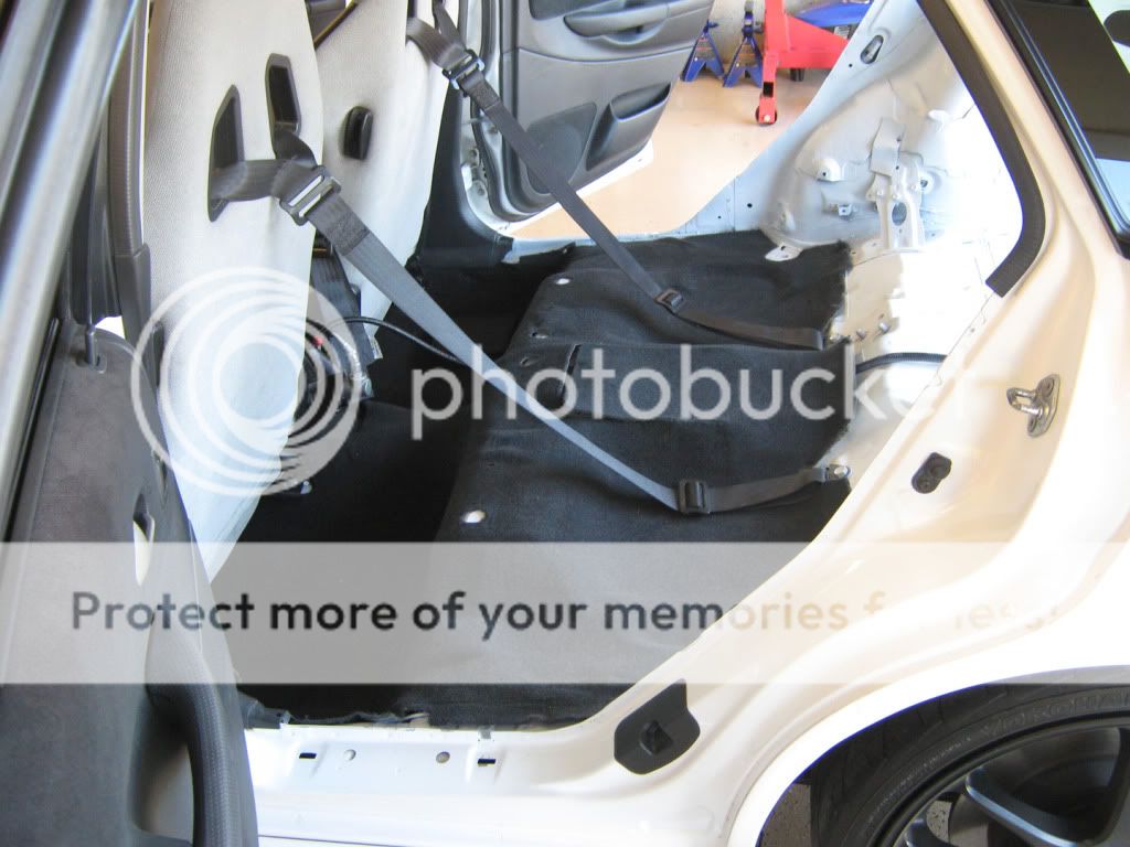

be careful with the way you have your seat belt attached to the floor. they are attached the wrong way. if you every get into an accident and hit the seat belt will compress your spine as it is attached downward. seat belt are suppose to be attached straight back and slight up.
safety first. get a roll cage and attached the seatbelt to the tube that would ran across the back, this tube must be higher then your shoulder, but never lower
you can have serious injuries thet way you have it now.
