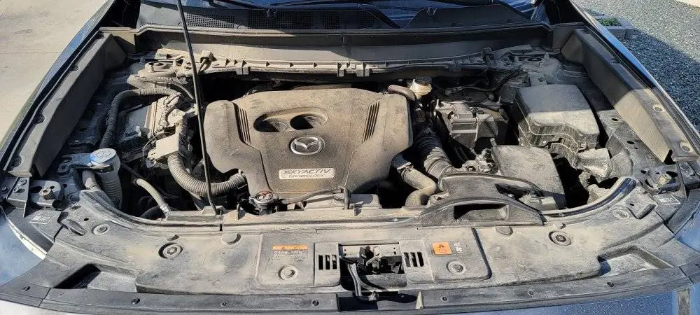

1. You don't have to do this, but you can drive the car around the block if its been sitting for a while to get the engine bay warm, but not hot. This will soften up the existing dirt and grime under the hood and make it a little easier to brush off.
2. Remove the engine cover. You just have to give it a good pull straight up and it will come out. Set it aside.

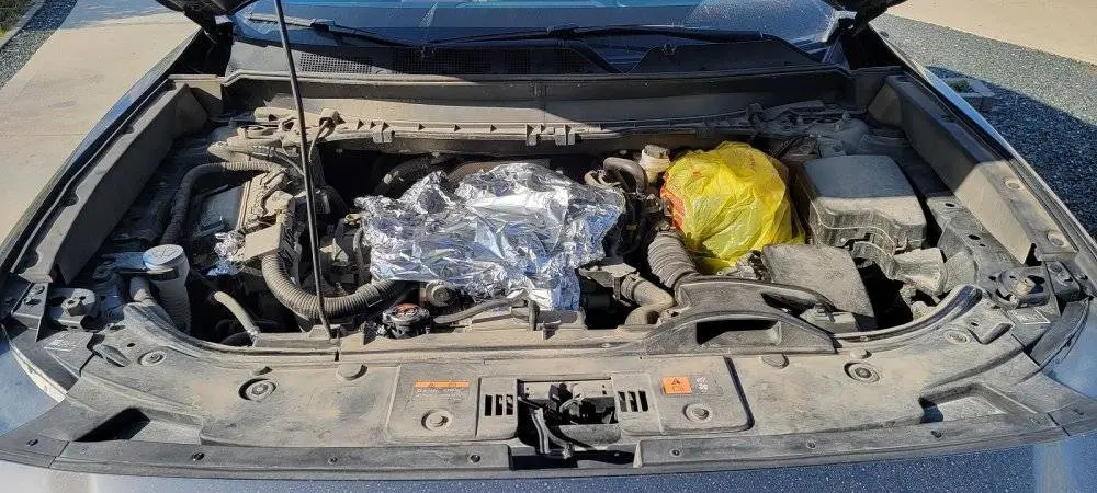

3. Cover the battery with a plastic bag to avoid getting it wet.

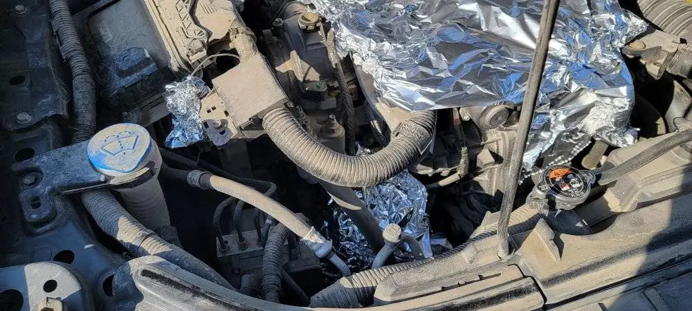

4. Cover the alternator, the top of the engine and any exposed plugs with aluminum foil. I used foil for this part because it's easy to wrap it around certain parts and it will stay in place. These parts don't need to be covered up as tightly as possible, I just did this to prevent the majority of water from getting onto/into those parts. Pretty much everything under the engine bay is water resistant. NOTE: If you have an exposed engine air filter (like the CorkSport, K&N, AEM air filters), cover the air filter element.

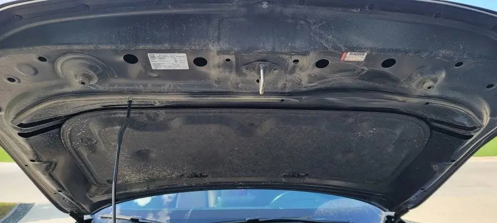

5. Spray the underside of the hood with Super Clean, then use the brush to agitate all surfaces. Rinse with a steady stream of water from the garden hose. NOTE: Avoid getting Super Clean on the exterior painted surfaces, as it can cause damage to the clear coat. Under the hood is fine because none of those surfaces are clear coated.

6. Dry the underside of the hood and the engine bay with a microfiber cloth or a leaf blower.

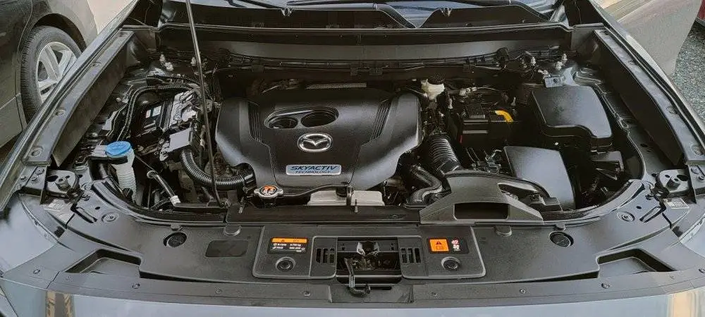

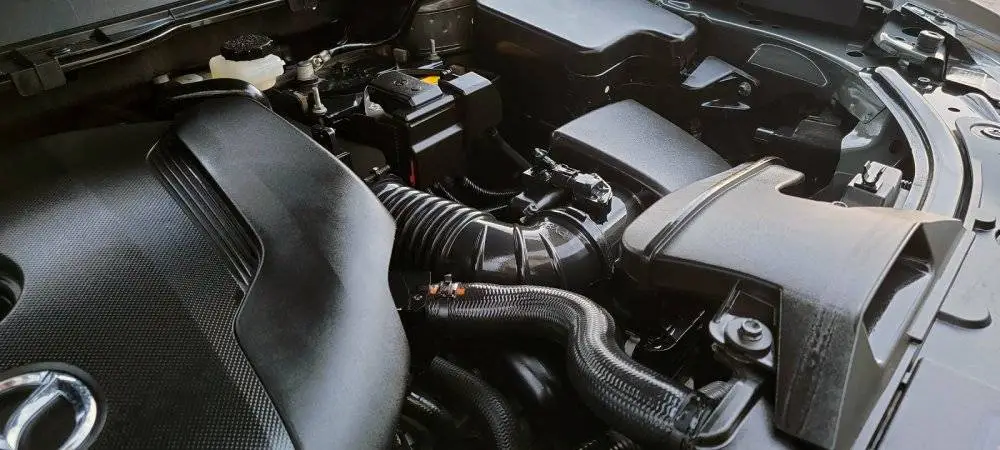

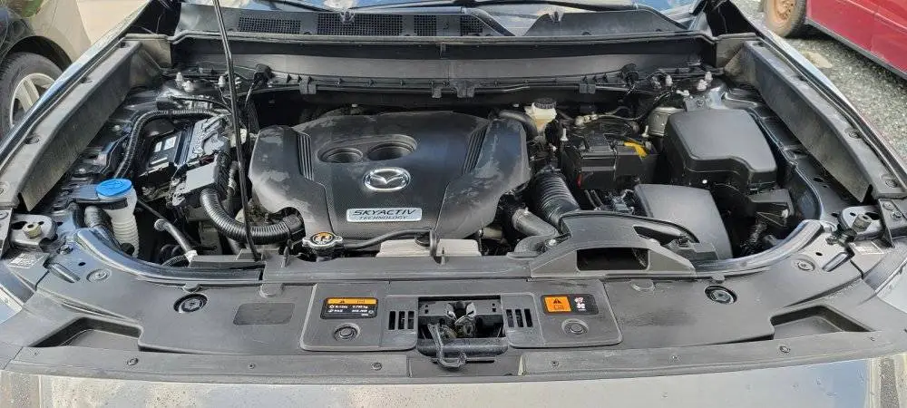

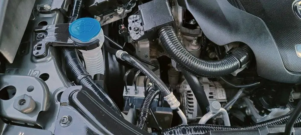

8. Using a damp rag, carefully wipe down the battery, top of the engine, and any other spots you might have missed with the brush. Below is a photo of the engine bay with the engine cover off, and all areas wiped clean and dry. If you disconnected the negative battery terminal, you can reconnect it now.

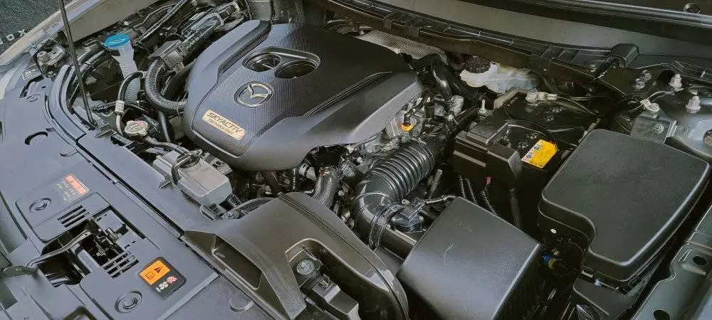

9. Spray the engine cover with Super Clean and brush it down, then rinse with water. Reinstall the engine cover by lining up the pins with the sockets. Below is a shot of the engine cover reinstalled.
10. To dress the engine bay, spray a coat of 303 Aerospace Protectant on the entire engine bay (avoid the battery terminals). You want an even layer to ensure that it doesn't appear splotchy when it dries.
