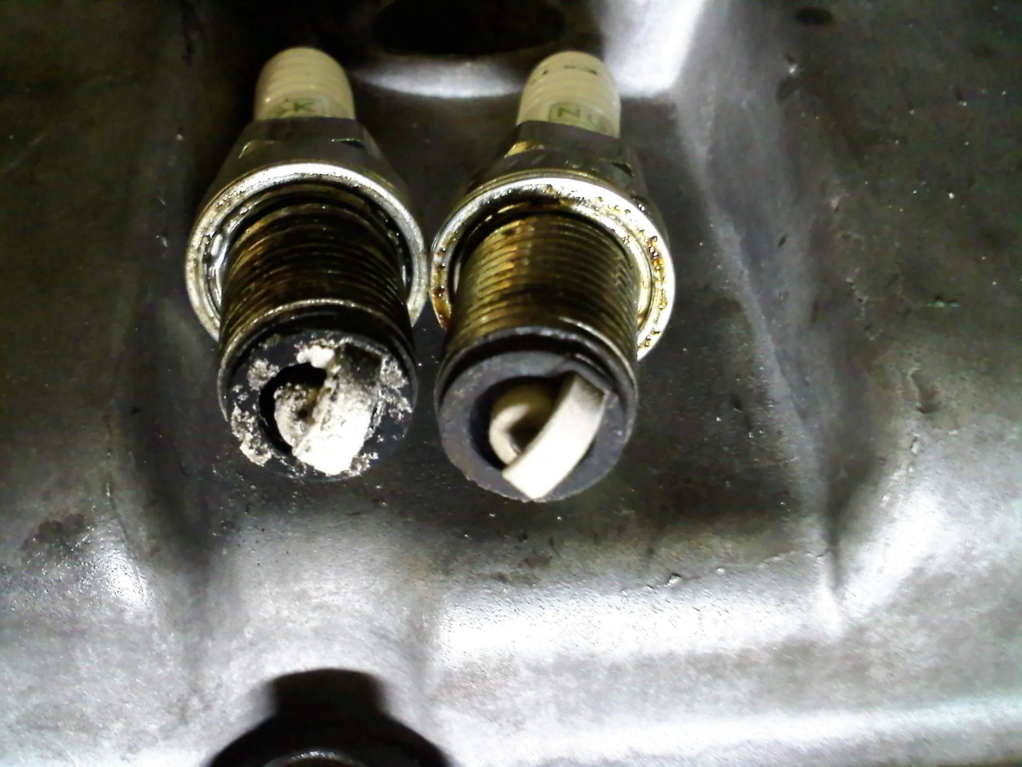

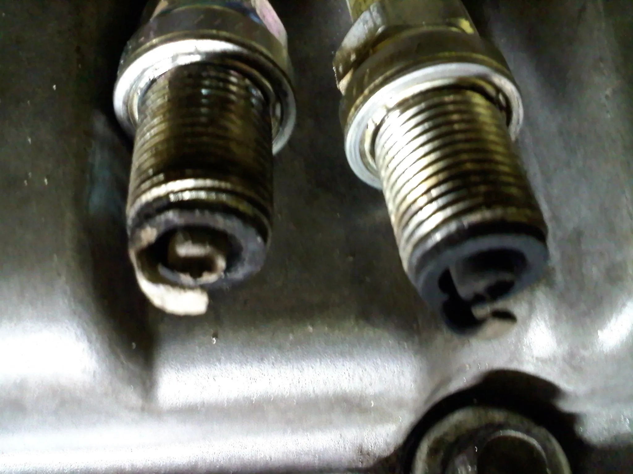

I did a dry compression test, then a wet. On the dry the compression in order from 1-4 was 145, 135, 80, 145, the wet in order was 200, 180, 150, 200.
spark plug one has white build up (chunky) sp. two and three are dry and look normal, sp. four is wet with oil.

If there is water in the chamber... the easy way to know is that the spark plugs will be much cleaner than the others..
Steam Cleaned...
He has sp plug pics above but not sure what order they are in. If 1st pic = 1 & 2 then 2 looks clean. If 2nd pic = 3 & 4 then 4 looks cleaner.
Yeah, 1st pic is 1 and 2 and 2nd pic is 3 and 4. Another time I took the plugs out right after running and #4 was wet with what looked like oil. Anyone have any good links of full FS-DE engine rebuilds. What's a good set of rods, what to they go for$$$? Thanks for all your feedback btw :-)
