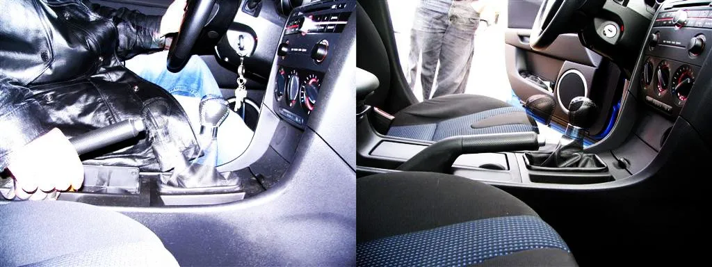

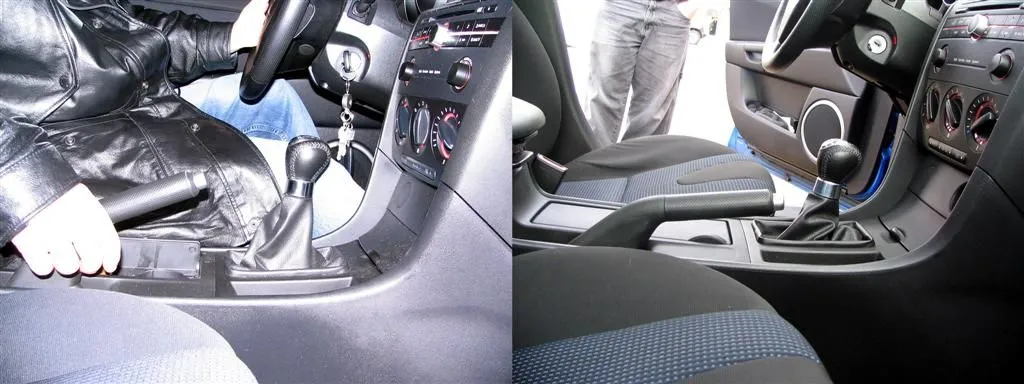

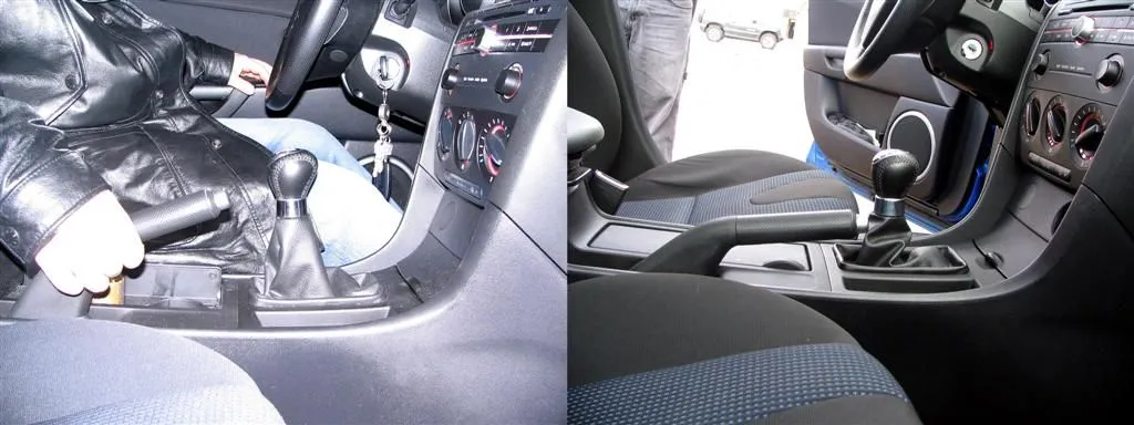

I made my own version of a short shifter today. Took about 30 minutes and works great
Basically, I used the factory shifter, shortened the overall length of the rod, and raised the location where the cable attaches to so it not only is a shorter shifter, but the throw has been reduced as well.
Here are the before and after pics
First pic is in 3rd gear
Second pic is in Neutral
Third pic is in 4th gear
Fourth pic - random "in progress" pics

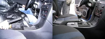

One more pic.. An overlay showing the total throw from 3rd to 4th.
Shifts are just a flick of the wrist now, and best of all, it cost me nothing.
The only significant difference from my home made shifter and the TWM short shifter (rev 2) is that mine does not have those 4 aluminum bushings.
Personally, I prefer the rubber bushings.

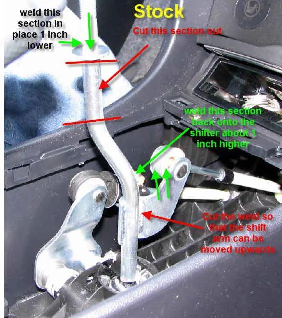

I cut a section of rod out and re-attached the original threads onto the now shorter shifter.
More importantly, raised the arm that connects to the shift rod.
This pic is basically what I did.

Honestly, it took under an hour from the time I parked my car to the time it was completely modified and installed.
After the first one, I'm sure I could do the next one even faster knowing now exactly what needs to be done.
Removing the shifter from the car is a 5 minute job, Don't even need to remove the console, just pull out the drink holder and the shift boot assembly, then 4 10mm bolts and that's it.
Everything snaps together.
For the pics, I set my camera to take multiple pictures 1 minute apart and placed it on the arm rest on the passenger side of the car with the passenger door closed. So the before and after pics are taken from the same spot.
