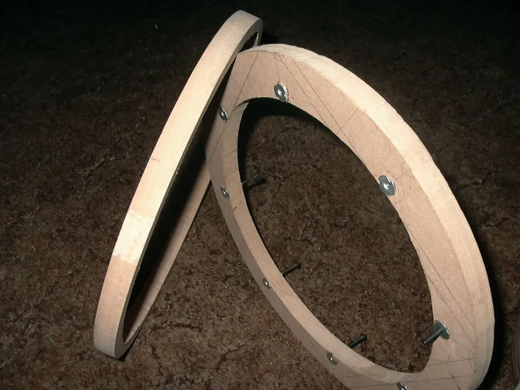

Okay, so once again, I'm taking my sweet ass time to get it done, but now I've gotten to the rings. I was about to trim my box to shape, but it was late and that thing acts like a speaker as it sits, so the sounds of the dremel got neighborhood piercing-loud... So a couple notes on rings. 1st, That is my spendy ($25) circle cutter jig that I'mgoin to tryto take back and say sucks. it's flexy and crappy. I had to work over the rings with a dremel pretty heavily to get them down to somwhat round (fortuantely I was overly conservative with very circle and needed to lose some material anyway)
I used t-nuts which actually turned out to be easier than i'd imagined. I used #8 nuts with allenhead bots. Was thinking of going bigger, but figured that the holes would wind up overlapping the cutout hole ALOT. as-is they just barely get into the cutout, but not enough to hit the speaker. I used a bit of glue on them as well t tomake surethey won't pop out easily..

yeah, i'd even suggest fiberglassing those little buggers in. noting worse then having one pop out on you and not being able to get your speaker out, i ended up having to cut a hole in the side of one of my boxes to get behind there to hold the t-nut while i unscrewed it. those things are great but if not in securely while your screwing the allen head in they can come loose and start spinning and the little prongs can flatten out wich is what happened to me. so make sure they are in there good.
im glad i never bought one of those tools. i saw them, but i just stuck with my good ol jig saw. works every time. i think im gonna use t nuts with my boxes too. ive always just used wood screws, but if im going to all this work for a box, im getting some good bolts too. im gonna put a drop of glue or liquid nails to hold the nut tho, like sndsgood suggested. especially since ive already got my rings glassed in before i made any holes. ive worked with them a couple times making other things and they can come loose and spin sometimes if theyre not seated properly. but anyways, almost ready to fleece then huh. shouldnt be long now before its finished.
i thought about it, but it was an allen head and pretty thick. i just said screw it, cut a hole in the box, fixed the problem then sealed it back up.
I actually already had one dothat. I was setting them all in with gorillaglue, andapparantly some of the glue form one of them got into the threads... prettymuch just had to dremel that one off, and yank it out... hopefully I don't have problems, but *shrug* my sub mounts up REALLY nice... I was gonna glass them into place, as well as bond my rings together thaway, but but then again there's the issue of getting resin in the threads... ohwell, gorillaglue hasn't let me down yet. I've got a buddy who glued a bowling ball to the ceiling of his apt. still uptehre 6months later... not to say I don't get nervous walking under it...

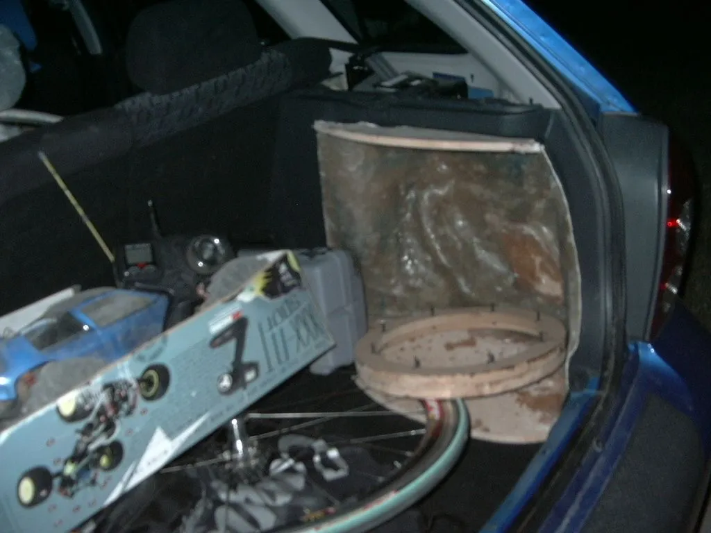

oh, yes and on the inside-car pic, this is the reason why I need a glassed-in compact box. My hatch looks like this all too often. It got to be quite a pain with my old clunky wood box. I'm enjoying the extra space already!

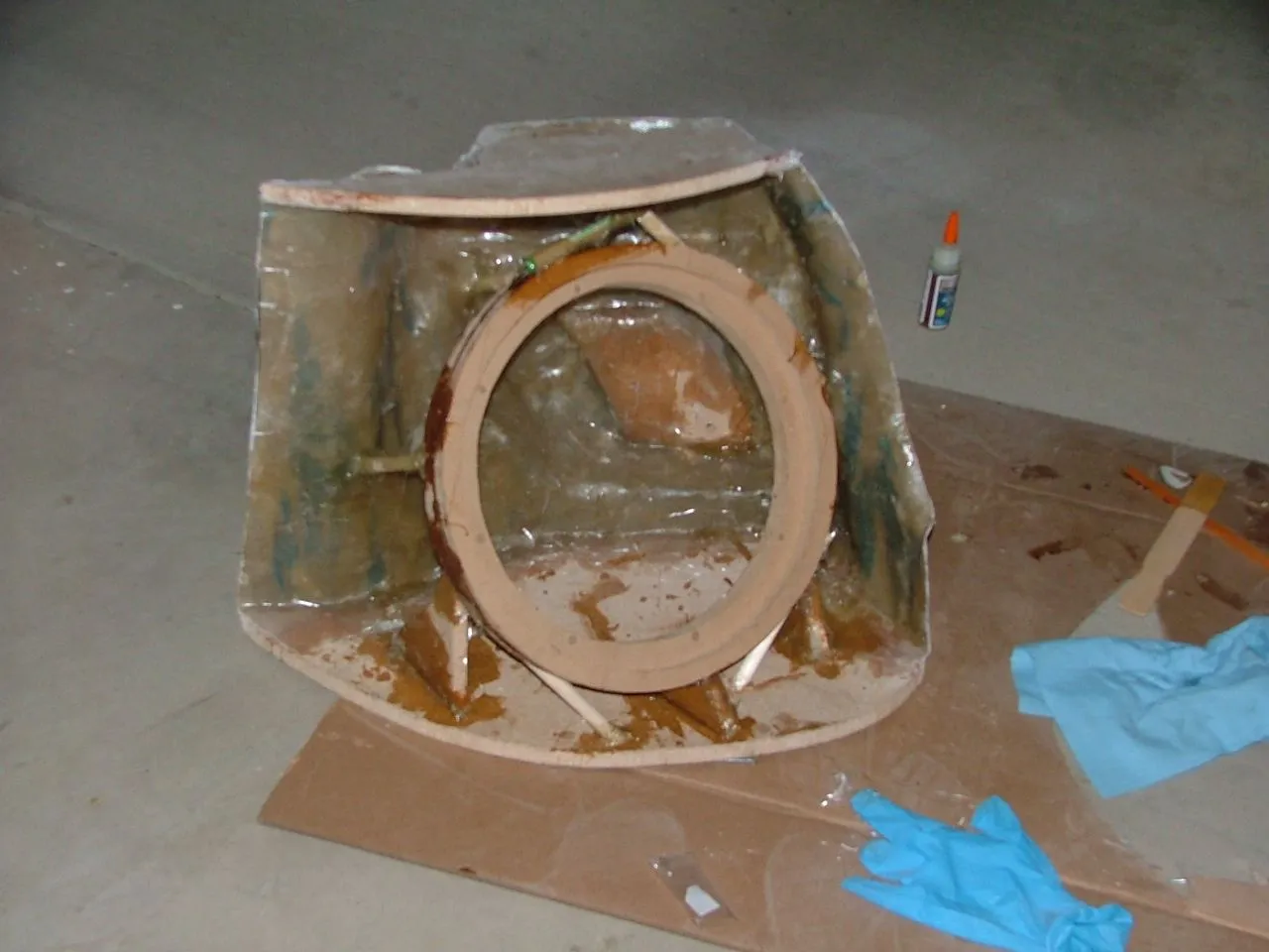

ring in place ready to fleece
Okay, so I found some time today, and managed to get my ring sticked into place. First I used hotglue, which seriously impressed me with it's strength, Nonetheless I also glassed the ends of the sticks to make sure they don't come out. (that's the wetspots) hopefully it'll dry nice and solid. I figure some of the crossbraces might actually strengthen the box itself, but it'll hopefully be negligeable.
