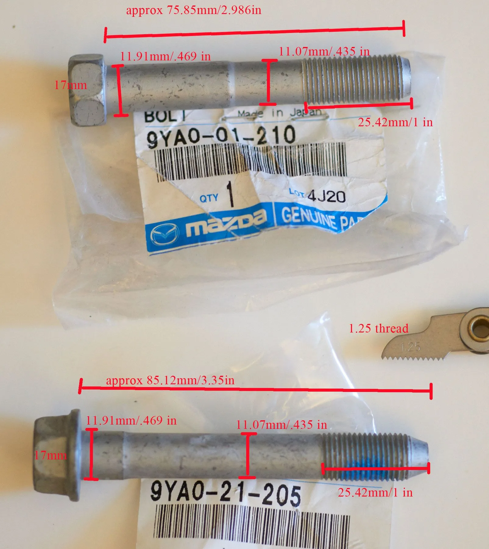

The middle bracket bolts, that goes through the bushing, are missing.
I ordered it from the dealership, waited two weeks, and got the wrong bolts. As it as, 3/4 bolts are in both control arms.
Recommend a site or hardware store? NAPA didnt have anything.
I just did my LCA's and used the old bolts. All I can tell you is that its definitely a 17mm head. I'd wager that they're all the same thread diameter and pitch though. You could try just going to a hardware store and buying a high grade bolt.
Try a wrecker ...
(bring along the bolts from the other side for comparison)
I had to get lca bolts from the dealership. I couldn't find them at any local hardware stores. If you are talking about a horizontal bolt, it's the bottom one in the pic.
fyi: upper bolt in pic goes through the bracket into subframe (it's the longer of the 3 subframe bolts)
