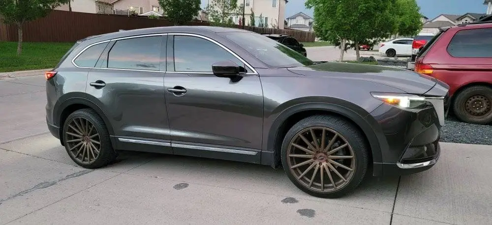

Just read through every post of this thread and I love those wheels you added. Were you able to re calibrate the speedometer or are you just dealing with the speedometer being off?
Thanks! I just deal with the speedometer being slightly off. The variance is pretty minimal (about .5 km/h difference at around 100km/h) so I don't even have to think about it.
Its been almost a year with the vossen wheels and last night got 1 of my wheels scuffed getting out of a drive thru..living in new York is a challenge to keep wheels perfect, trying to find some paint for satin bronze? Any recommendation
Satin bronze is definitely hard to match. I use a nail polish as touch up paint for my wheels, but its nowhere near a perfect match. It's quite durable though. I would suggest checking out your local Shoppers/CVS for a nail polish that might match.
If you wanted something closer, you could try an automotive paint mixing shop?

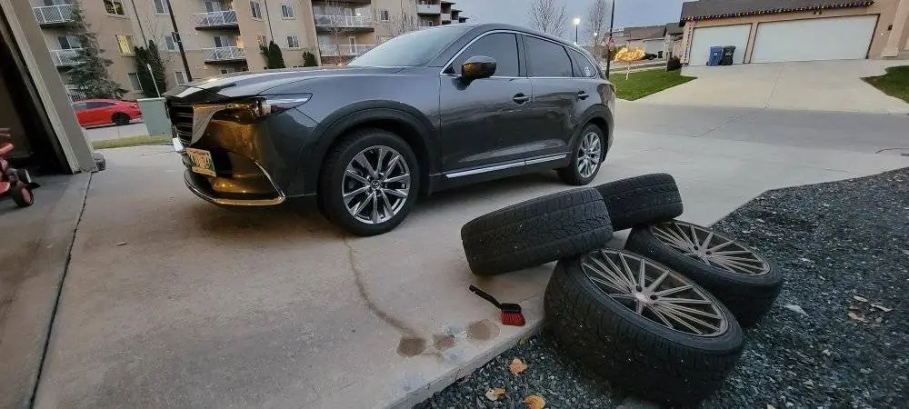

Swapped to my winter tire set over the weekend.
20211107_171225-jpg.304508

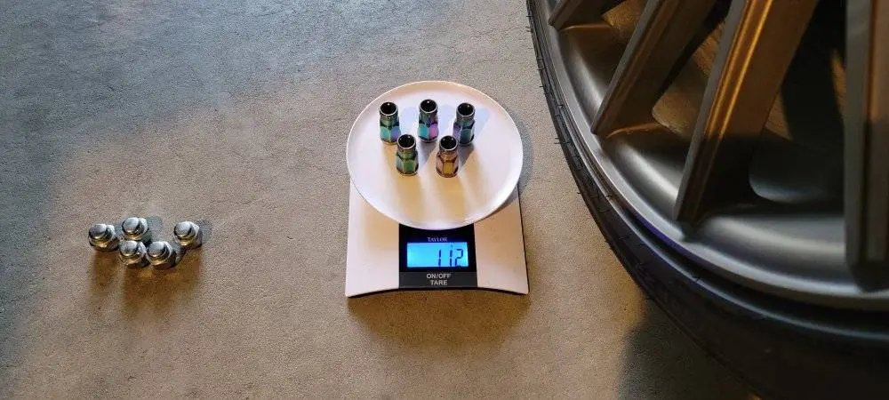

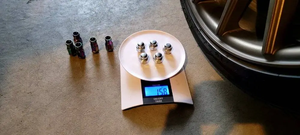

I also realized that I forgot to mention a mod that I did when I first got my summer wheels 2019. I needed a set of aftermarket lug nuts for my aftermarket wheels, so I ordered a set of titanium lug nuts. Here is the difference in weight between five OEM lugs and five titanium lugs.
The difference is about 46g per corner.
