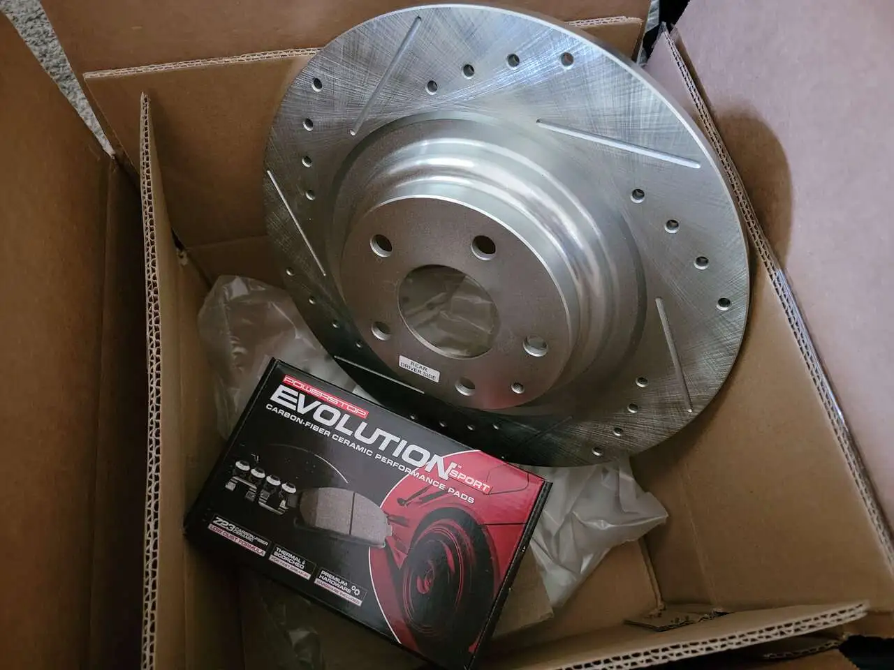

Parts for rear brake maintenance came in a couple of days ago. New rotors and pads from Powerstop.
Will be installing these hopefully this Sunday. Going to also try to pull the front bumper off so I can finally install the JB4 and the aftermarket horns.
EDIT: I also weighed one of the rotors using my bathroom scale. One rotor weighs in at 13lbs. I'll weigh the OEM rotor as well afterwards, just for curiosity's sake.

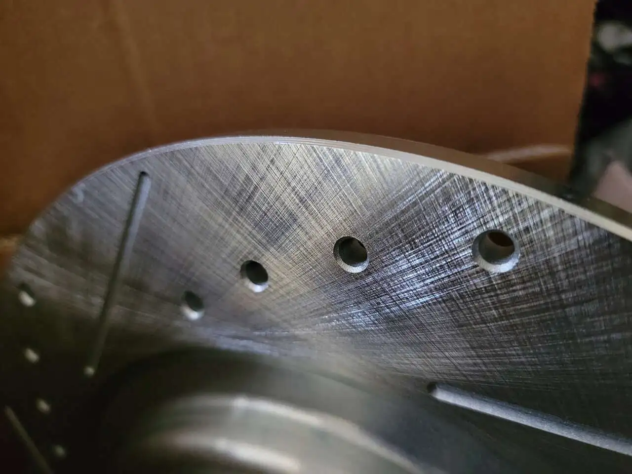

Also for the record, I'm aware of the potential down sides to using a drilled/slotted rotor (additional noise, risk of stress cracks developing around the holes). I'm hoping they last at least 4-5 years, but just in case they don't, I'm holding onto the OEM rotors.
I have slotted rotors. I worried about the noise too but so far they've quiet except in reverse. Make sure you pay attention if they have specific direction.
Yeah it looks like they have stickers on each rotor that specify which side they go on. Initially I wanted slotted only rotors but none were available locally or through RockAuto, and Powerstop currently has a $15 USD mail-in rebate offer going for the month of August.

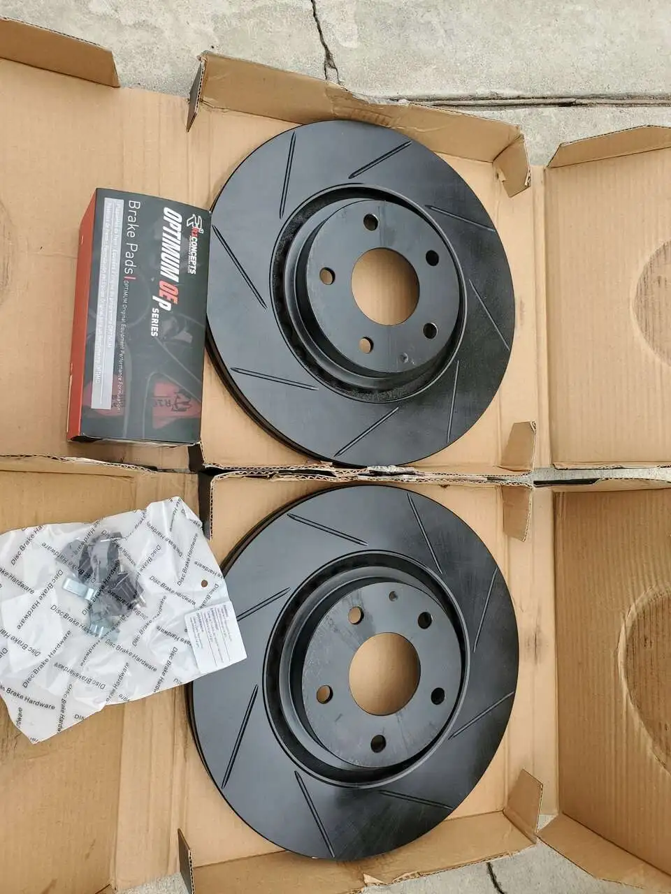

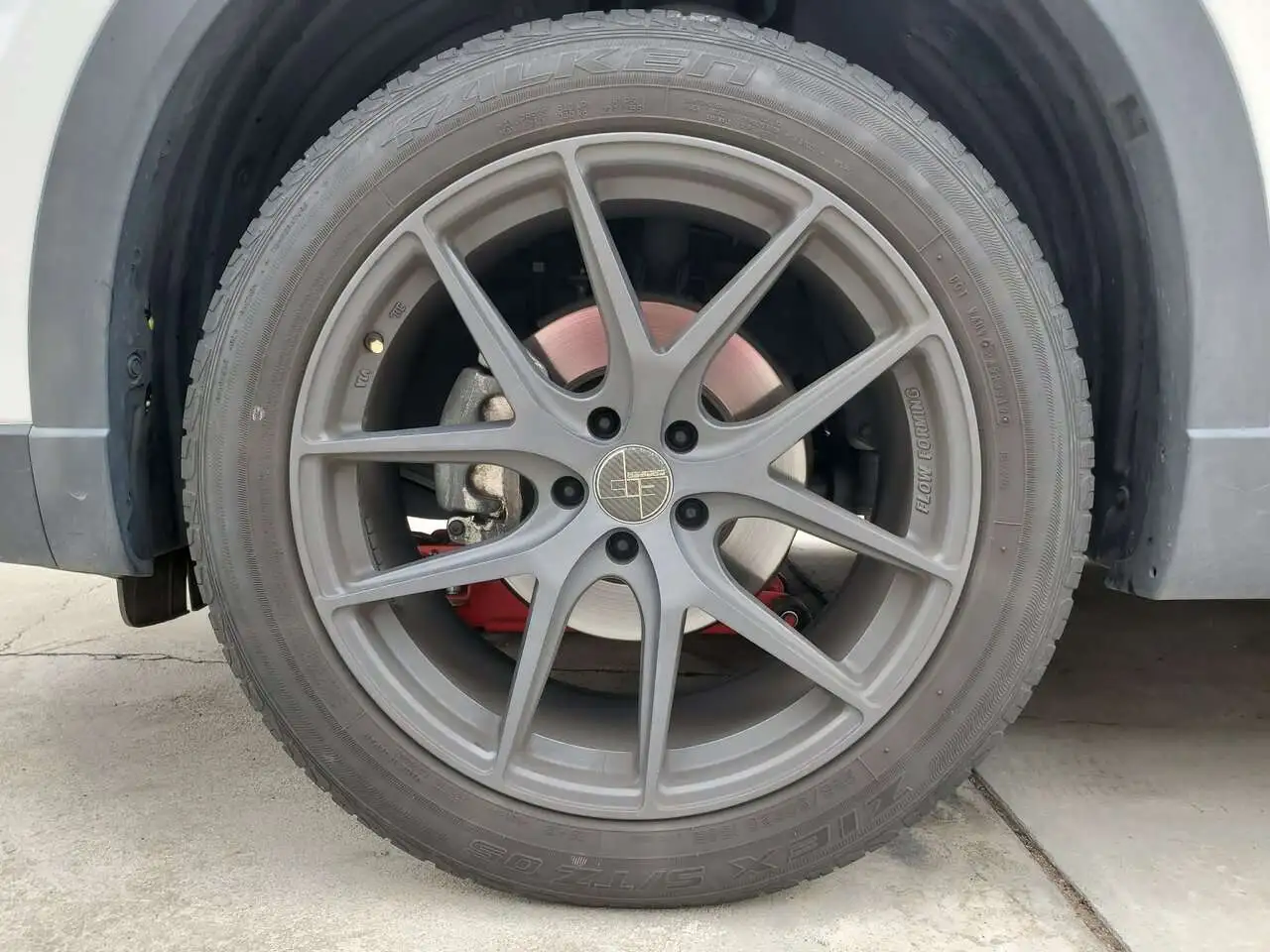

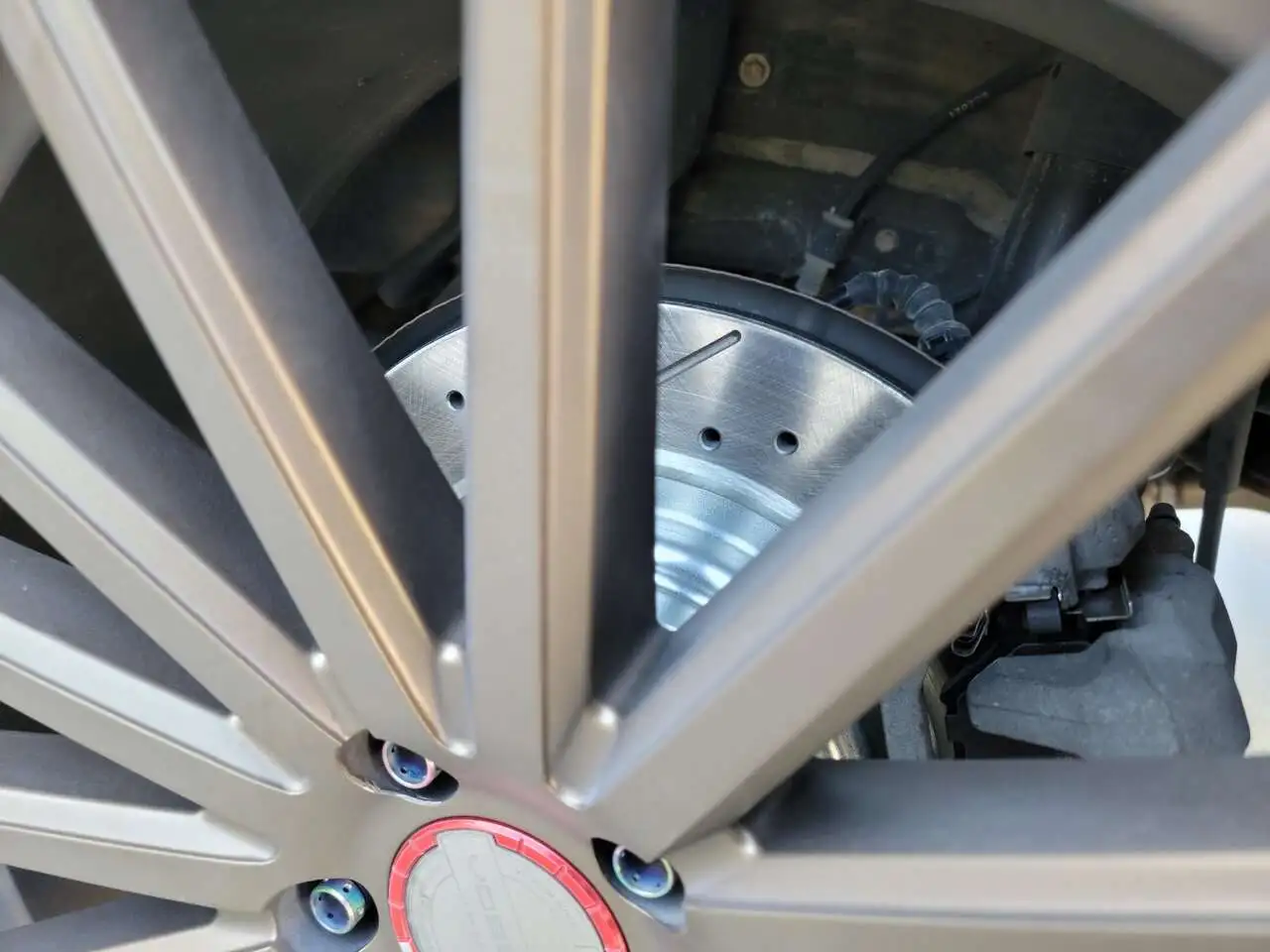

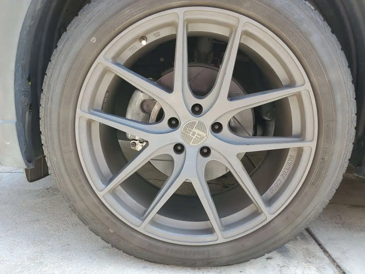

Would you mind posting a pic of your car with the slotted rotors? Which brand did you go with, and what pads did you pair them with?
They're subtle and hard to spot behind the 20s.
I think R1 Concept is the only company I've found that carry slotted only. I went with their "oe" pads which supposed to be low dust and same bite. Not low dust at all but no complain with the stopping power. As mentioned, zero noise except when in reverse. Overall very happy with them.

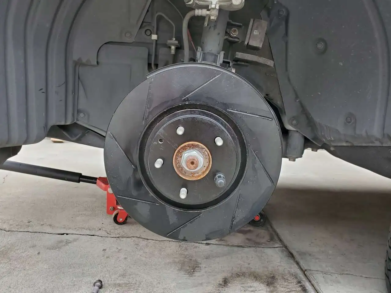

Got my new rear rotors and pads on. Powerstop Z23 Evolution Sport kit (K7742).
I weighed the old rotors, and they came in at 12.2lbs each. Rotor width was at 11mm.
