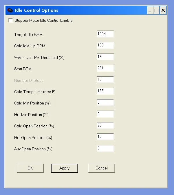

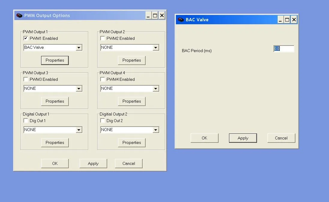

Totally made sense, but the Haltech has settings where you can tell it how many times to cycle the solenoid (50Hz, 100Hz, 10Hz) whatever you want per second, so it doesn't "hunt" too badly. Here lemme post a screen.

Here we go. First shot is the actual idle parameters setup, so hot idle RPM, then how much to add for cold idle, and post-start idle, etc. Stepper motor box is unchecked cause the Protege uses a BAC (bypass air control) valve.
Second shot shows how you can adjust how much the solenoid cycles.
Looks alot more sophisticated than the MT
basically, we have an Output idle air min and max setting (minimum and maximum time the valve can be open for when activated, in milliseconds), a cold start adjustment and a link up to an input for idling up with an accessory
