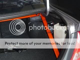

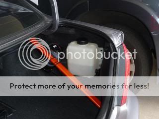

i have my tank and pump mounted in the trunk. i think it looks clean but it definitely was a MOFO to install how i liked it. il post pictures of my setup later if anyone is interested.
I've been planning a trunk mounted tank/pump, so I'd be interested in some pics of how it's been done.
tank and pump mounted in trunk:

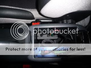

progressive controller in center console (next to j and s safeguard):

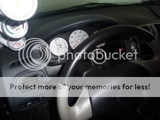

methanol flow gauge (steering column pod):

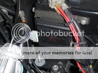

failsafe mounted to the battery case (slips in and out of pocket for easy removal):

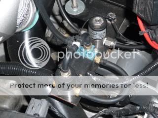

injection solenoid, haltech boost solenoid, and boost bypass solenoid (mounted on a bracket):

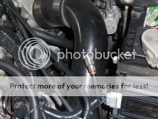

pre-throttle body nozzle:
Nice setup, accept for the plastic vacuum T. In my experience, they can fail easily for boosted applications. May want to replace it with some type of barbed metal T instead.
Clean setup. I like it!
Thanks for posting pics
thanks, np.
thanks for the compliment.
i dont know why your's failed (could have been a manufacturers defect or extreme heat exposure), but plastic fittings are plenty strong. i used 2 plastic T's on the brake booster for several years and only recently replaced them with a vacuum block and brass fittings. the plastic fittings were in great shape.
i do agree metal fittings are stronger, but the ID of these vacuum lines is incredibly small. Assuming constant wall thickness, the smaller the radius of the fitting, the less circumferential stress (Hoops stress) there is.
this thread is very informative. ive been considering MI for a while. so what kit is that that you have? and what kit is the best for the protege?
