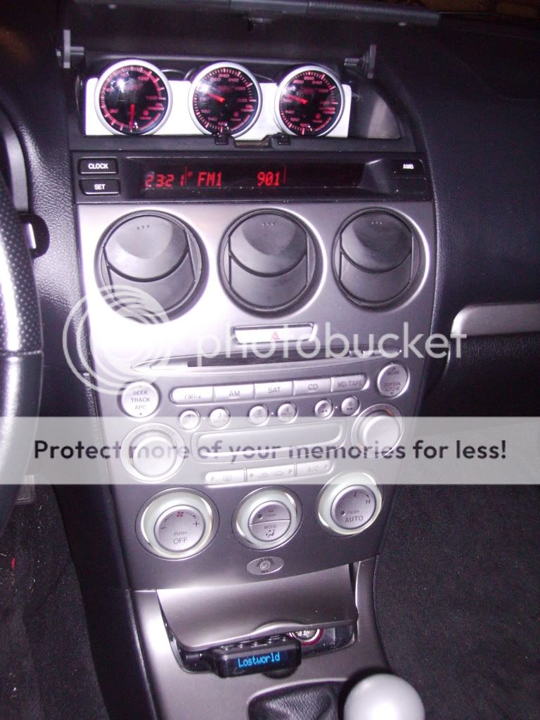

Day Mode, matches my white letter, black face OEM gauges.

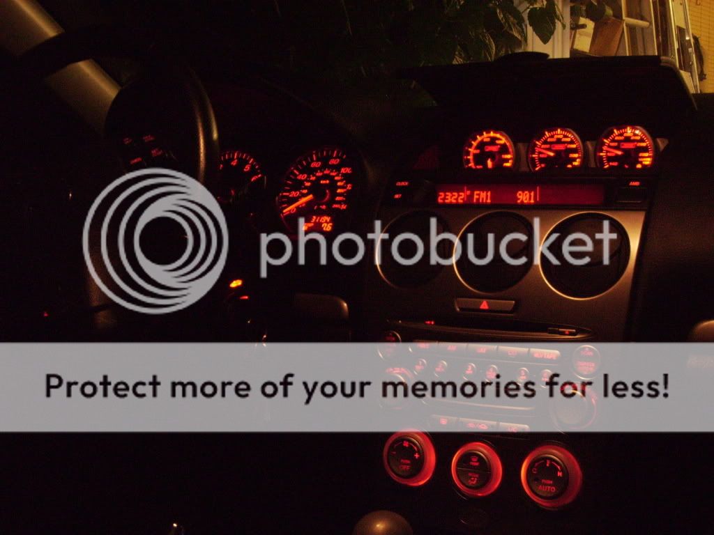

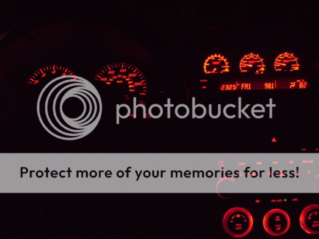

Night Mode

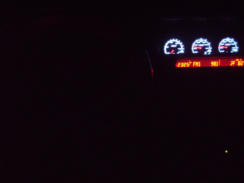

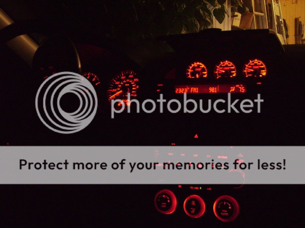

Trying to show the panel.
Night Mode
