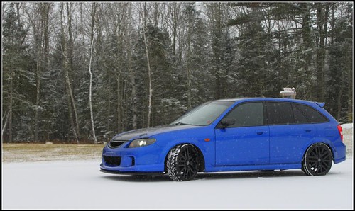

2003 Supercharged Protege5
Exterior
DG CF Grill- OE mesh insert
DG CF mirror covers
DG CF rear spoiler
DG CF rear valance
Xcelerated CF hood
JDP CF lip
MSP Lip
Isport CF spoiler add on
TRFS Morimoto mini retrofitted headlights
Aerocatch locking latches
Hella supertones
rear wiper delete
8mm spacers- arp extended studs
Deleted door panels
complete respray in a darker Laser blue
roof sprayed Ford GT Black
Shaved hatch
Shaved front Protege5 bumper
tint 5% everything behind the "B" pillars
Rolled fenders
S2000 antenna
City Light mod
Yellow high beams/drl
AAC sag fix
JDM side marker lights- came off a car in TNT from Japan
JDM taillights- came from friends in TNT
Interior
Speed3 front seats- rewrapped in leather/suede and blue stitching
Black suede headliner
Black suede pillar covers
Blue suede wrapped center gauge pod
rewrapped black suede door panels
wrapped dual suede cargo cover
black flocked rear plastics
MSP floor mats
rewrapped rear seats- leather/suede with blue stitching
CDM raised arm rest- top wrapped in leather with blue stitching
AEM gauges- boost, volt, wideband, temp
MSP door sills
OE Mazda auto dimming rear view mirror with compass/temperature
Intermittent wiper switch
Pioneer double din
Infinity components- 6.5" all doors
Polished gauge rings
wood hatch floor
Suspension/Wheels/Brakes
Ksport coilovers
GT SPEC Vbrace panel
GT SPEC Vbrace arms
GT SPEC Front strut bar
GT SPEC Rear strut bar
GT SPEC Lower tie bar
GT SPEC Ladder brace
GT SPEC Rear cage
GT SPEC Trailing arms
All GT SPEC pieces powdercoated satin bronze
Jay Racing Aluminum lateral arms with custom SS bushings and SS hardware- powdercoated gloss black
Raceline adjustable endlinks- rear
Jay Racing Adjustable endlinks front
Mazda6 front brakes
AWR rear sway bar
Energy suspension sway bar bushings- greasable rear bushings, front bushings
Mazdaspeed6 18's powdercoated black 215/35/18 tires
White line control arm bushings
CS braided SS brake lines
Engine bay
CR3 Rad brackets
CR3 ADP
CR3 Washer kit
CR3 Coolant can- AN fittings to rad
CR3 Pcv can- AN fittings direct to valve cover and to manifold
relocated lightweight battery- its where the OE jack was in hatch
626 intake manifold- shaved and unneeded vac spots filled
OBX header- ceramic coated and wrapped
Clutched M62 supercharger
CX racing FMIC
welded aluminum IC piping- wrinkle black
Perrin fuel rail
440 injectors
Jay Racing thermal spacers- TB and IM
Corksport exhaust hangers
mini vac line tuck and wire tuck
1.8L valve cover- shaved, cam cover cutout and AN fittings welded
1.8L coils and wires
Mishimoto rad
Mishimoto slim fans 10" & 12"
SU motor mounts
NRG CF hood dampers
AEM FIC
Corey CF AC delete panel
Vibrant vacuum block
AC/CC delete​
Congrats! I wish the featured picture didn't have snow in it. Very depressing to see more snow (nervous)
