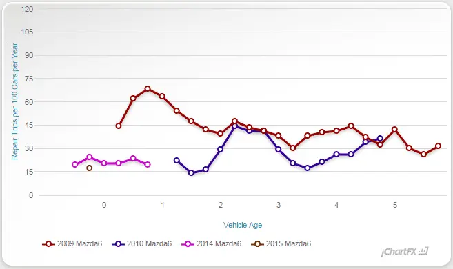

To view the new graphs, select "reliability trends" in the breadcrumbs at the top of the page. Or check out the attachment, which covers recent model years.
