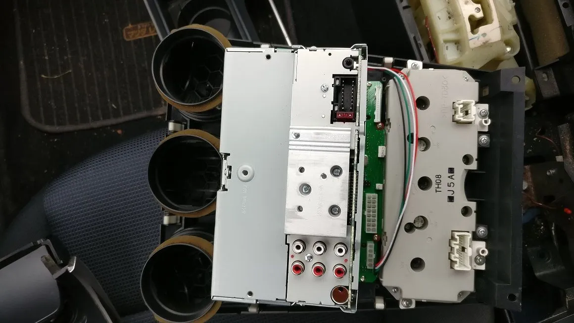

I sat at the work bench (dinner table) and did the next bit with the new fascia and the old fascia\head unit. Do not lose any of the screws you are about to remove, and try to remember where they came out from as they will be reused in the new fascia:
- remove the white aircon controls unit from the old fascia by unscrewing the 6 larger screws holding it in, and put it into the new fascia. Replace the screws so it is mounted into the new fascia
- remove the vents from the top of the old fascia by unscrewing the screws holding it in place, and put it into the new fascia using the same screws.

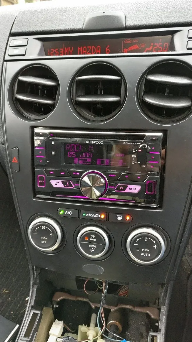

Now you can put you new head unit in - this is where I spent the most time as the head unit did not fit perfectly, and the mounting brackets were not a great fit either. The auction on Ali Express I bought them off also sent me two left hand brackets :( I used a drill and file to make the mounting grooves deeper, so each of the screws would fit and hold the brackets in place, and allow me to mount the head unit. At this point, pull all of the white mounting bracket clips off the old fascia and put them on the new one. They should come off easily but take your time so you dont break them. Also, there is a little oval plastic filler which can be swapped over that covers the hole under the aircon dials. It isnt the same colour or texture as the new fascia
Heres what the new fascia looked like built:

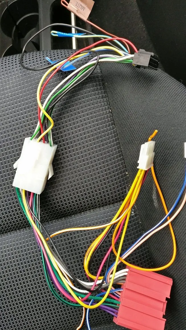

Next I had to create a wiring loom to convert the plug in the car to the new fascia. Here is where you need to do a bit of custom wiring. I used the cable that came with the head unit (a Kenwood Double Din CD\Bluetooth) and spliced that with the cable that came with the fascia. You could use a standard off the shelf wiring loom converter here to connect the stereo to the car, but this will mean the air con buttons and display on the car will not operate. These controls and outputs go through the same wiring loom as the head unit in the car.
To join them up, you need to either solder or crimp connect them - the wires are all labelled and use the ISO standard anyway so its not too difficult. I used a plastic plug\crimp set I purchased from Jaycar to join the two up. Heres what it looked like before installation : mazda6-wiringloom.webp

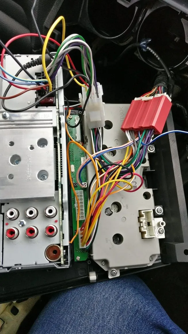

Plug that into the new head unit and fascia - there is a five wire plug which goes into the fascia circuit board and a two wire pink and blue plug which goes onto a two pin plug in the middle of the board.
Heres what that looked like: mazda6-wired.webp
Now it all needs to be installed - be gentle as you do this as one of the wires on the new wiring loom have a tendency to pop out (the two wire pink and blue one). The air con plugs go back into the same sockets on the Air Con controls, and the bluetooth mic wire plugged into the head unit. The wiring loom should plug straight into the available plug for the head unit, and the antenna cable plugs into the head unit. Once all the wires are attached, double check that pesky pink and blue one which may have popped out again. Now gently push it back into the mounting and set it into place - make sure the wires are all tucked in safely behind the head unit and are not caught up on anything. My antenna wire is quite short and it the last thing I plug in before seating it into place.
To join them up, you need to either solder or crimp connect them - the wires are all labelled and use the ISO standard anyway so its not too difficult. I used a plastic plug\crimp set I purchased from Jaycar to join the two up. Heres what it looked like before installation : View attachment 217279
Heres what that looked like: View attachment 217283

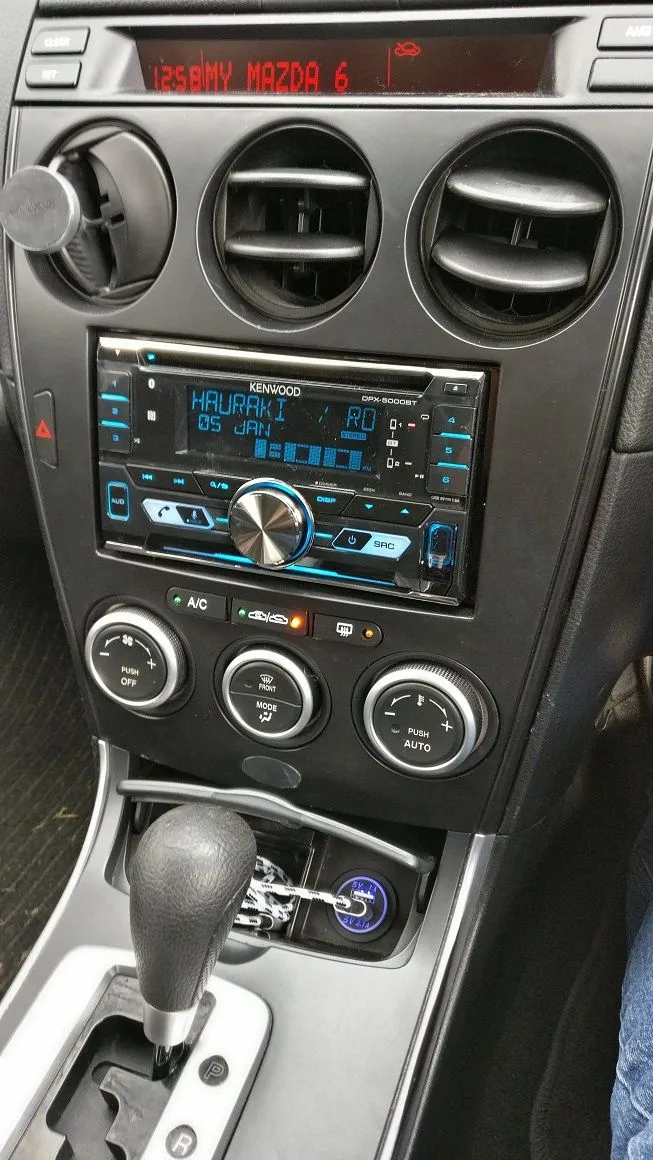

Mounted:

Done:
Hope that helps someone - let me know if you have any questions.
