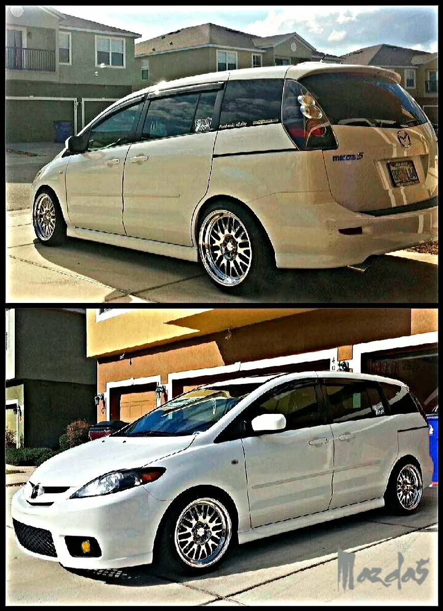

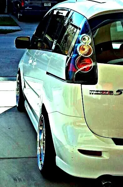

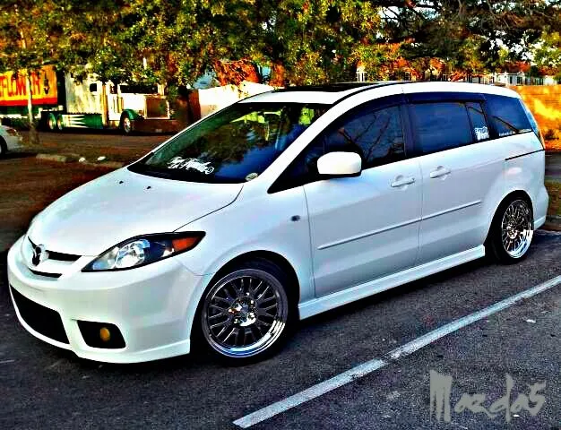

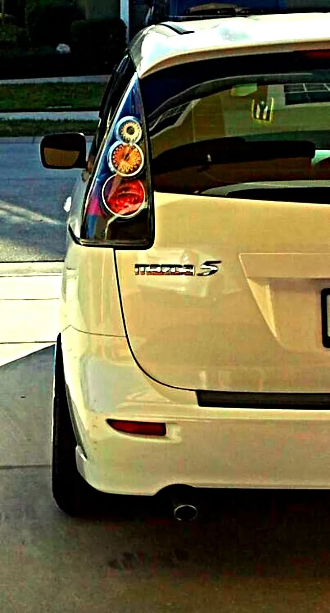

Had a chance to put on my old rims from my civic
Specs: ssr type-f 18x8.5 +48 with 215/40/18 tires coilovers are on the way and switching to 245/35/18
My Mazda5 on 18x8.5/9.5 +35 225/40/18 Tires slight stretch on rear
Feed back on wut yall think? Thanks..
Lowered on megan lowering springs 1.75 all around
All four fenders rolled...Didn't need really plenty of room still mit go lil lower (Maby)
No rubbing at all with the set up i have
no camber..still stock just got front alignment done
just wanted more aggressive look ..lil deff from others:)

looks sharp
tell us all the specs and what, if anything, did you do to make them fit? i'm assuming the setup can handles normal DD duty with no rubbing, correct? Do you have alignment print out to share?
oh, and why the staggered fit on a FWD?

Specs: Megan Racing Street Series Coilovers, bottomed out as much as possible without removing a collar, 225/40/R18 tires on MS3 GenPu wheels.
