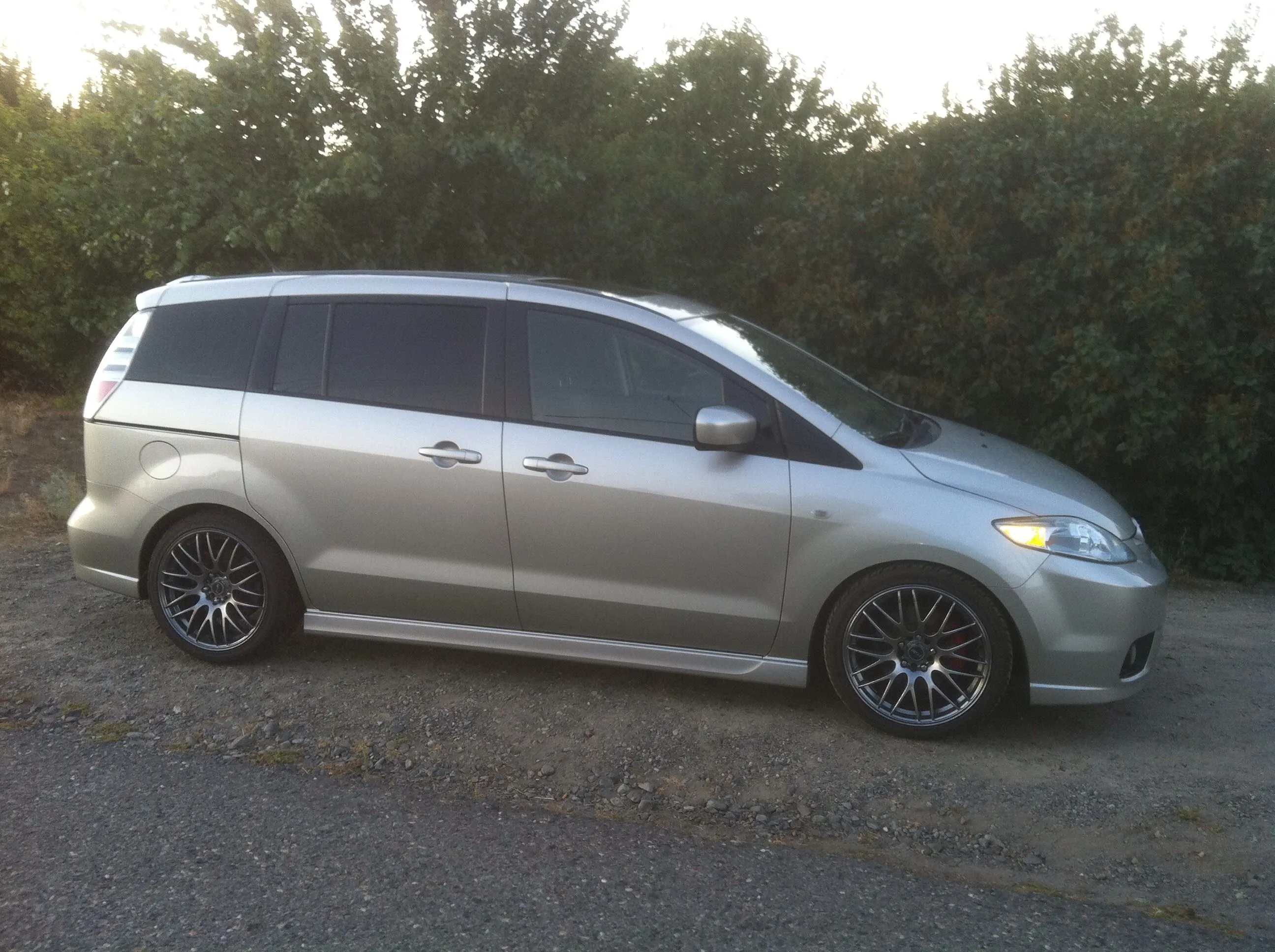

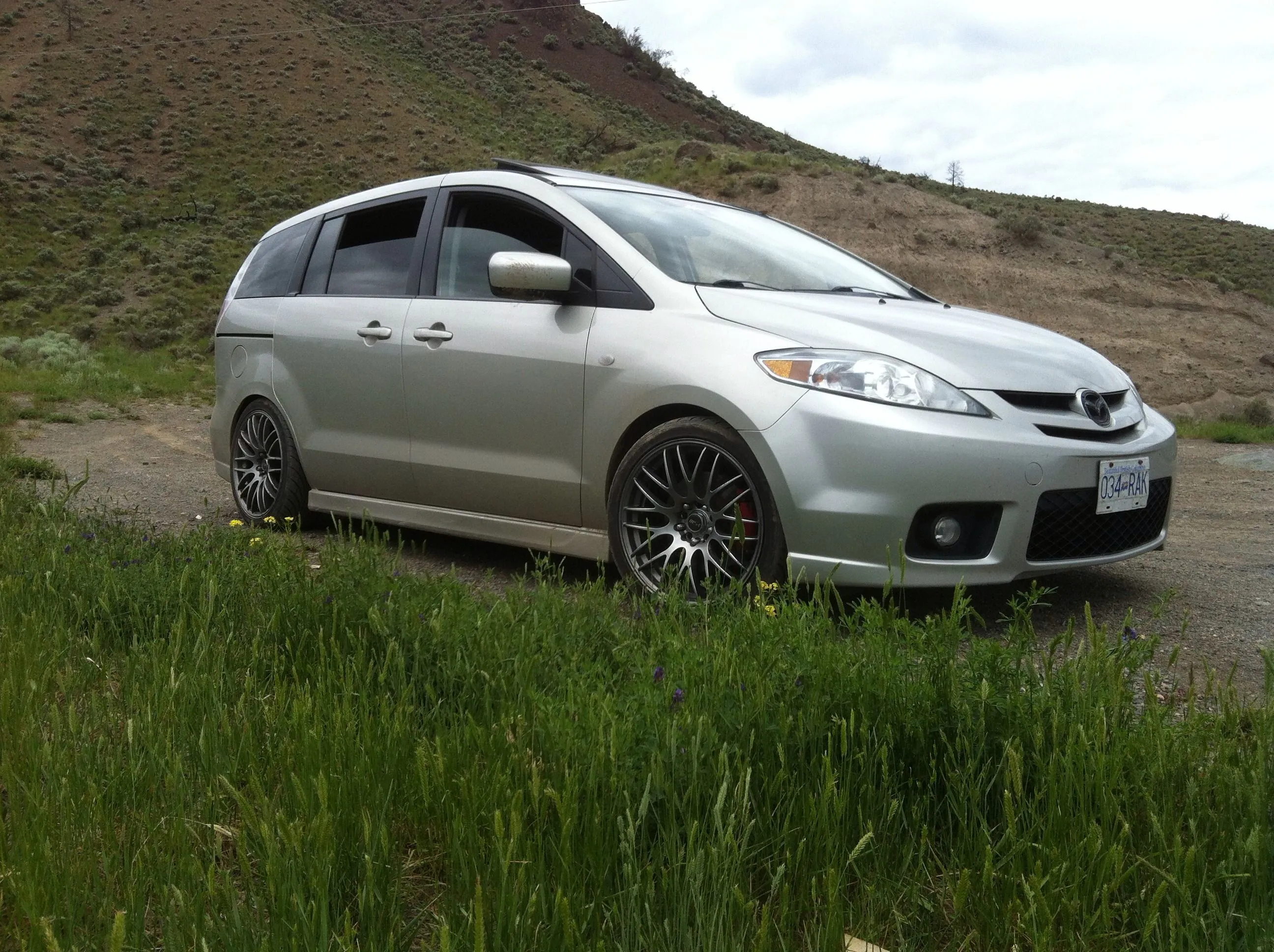

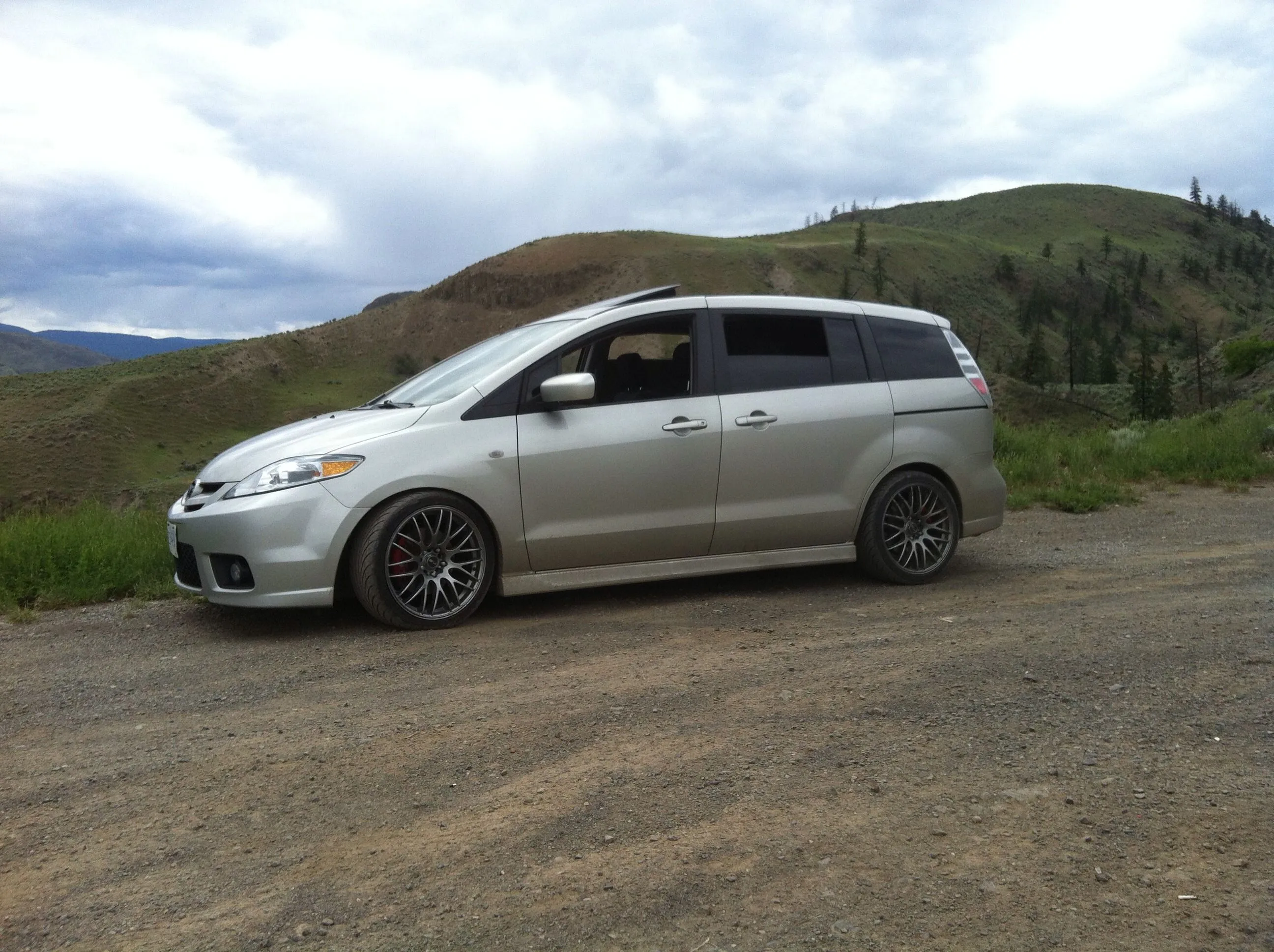

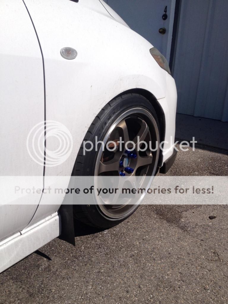

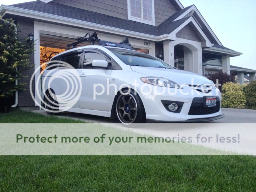

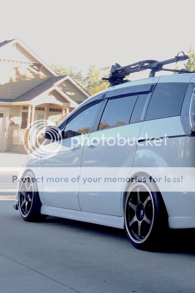

Here is my new set up for now-
18 x 8.5 +48 5sigen Pro racer GN+'s
215/40/18 Nitto Neo Gen's
my 5

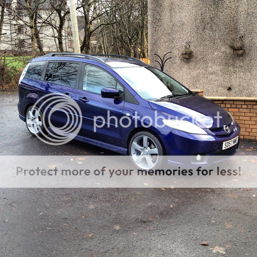

Lowered on HR springs, MSR 18x8 wheels, 225/50/18. Had to roll rear fenders. Shaved off rubber on the first bump.
I love the fitment. Any rubbing or rolled fenders?
where can i get a lip like this ?
Its on ebay. I love the front view but not the black that wraps around to the side
http://www.ebay.ca/itm/08-10-MAZDA-...Parts_Accessories&hash=item53ee6cfb3c&vxp=mtr
http://www.ebay.ca/itm/08-09-10-MAZ...Parts_Accessories&hash=item1e7204c91a&vxp=mtr

Thanks, Didn't have to roll the fenders no rubbing. Rolling six dudes deep, all 200+ still no rubbing. I'm sitting on the Megan springs for the 5...! I love the set up...!
