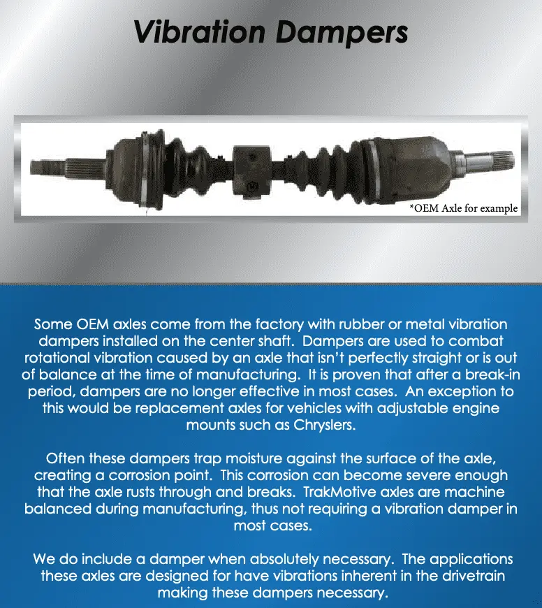

FWIW, TrakMotive's stance on vibration dampers, from this PDF on the O'Reilly website:
Did you notice any additional NVH without the dampers?

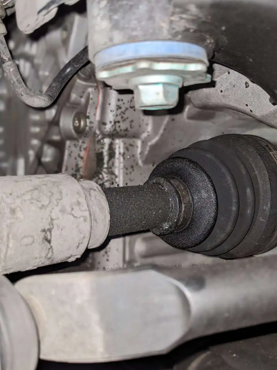

Picture attached is the current state of the driver's side boot. Passenger side has similar loss of grease, I believe.

That's a bit more spilled grease on the boot than I had on mine. Once you remove the old clamp, make sure there's still some inside trying to escape ;-)
I've used this cheap kit successfully on my second attempt. 1st one, I cut the strap too short to fold it correctly.
https://www.amazon.com (commissions earned) (referral removed)
And it was not a good idea. One boot turned out to have a tear, and the passenger side axle seems to clank. Gotta replace them both, unfortunately!
