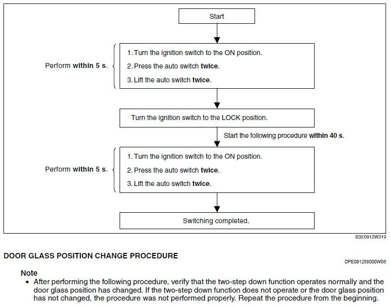

TWO-STEP DOWN FUNCTION OPERATIVE/NON-OPERATIVE SWITCHING PROCEDURE
Note
The following procedure switches the two-step down function from operative to non-operative and vice
versa.
I hope this helps...
