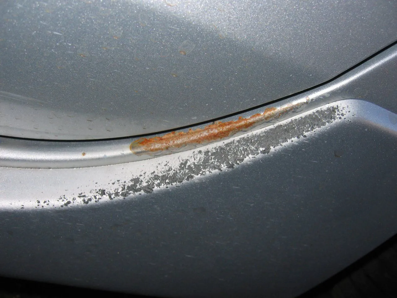

Regarding #44: I've attached a pic of gravel road damage (note: same on both sides of the car) that wouldn't have occurred if the body side moldings for the lower edge of the doors had been installed above the curtain molding. Anyone care to guess how much I can expect to pay for this to be fixed professionally? (I'm gonna do something about it before we hit the snow season, even if I have to get out my Dremel to surface it and hit it with some Bar Keeper's Friend and touch-up nailpolish^H^H^H^H^H^H^H^H^H^Hpaint afterward. (nailbyt) Will post update pics then.)

I'd be willing to pay $500 extra for a car if they'd put the 3M on at the factory. My car only had 2069 miles on it when I found it and it's chipped up pretty nicely. I guess someone enjoyed tailgating gravel trucks.
if i did the repair on that i would sand it down and prime it keeping the area small then back tape that edge by the molding and tape a hard line in the jamb then paint it then put a piece of the 3m protective tape on it since u prob don't have the stuff to do that i would sand it down prime it and brush touch it very lightly with many coats then put some clear spray paint on a brush and apply a couple coats then put your tape over IMO
Bar Keeper's Friend= bad idea
use 80 grit sand paper then work up in grits till at 220 for prime
ya might be able to get a shop to fix it for cheap if ya tell them how ya want it done
