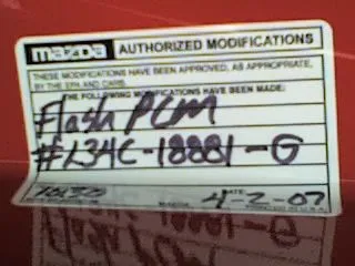

hunterbrandon said:
The "authorized modification" sticker the dealer put on my car has a flash number on it would that help you guys out?
It's worth a try but the car is suppose to get a reflash with the Mazdaspeed CAI correct?
hunterbrandon said:
right inside the drivers door jam
Hunterbrandon, so what is the flash number? It would be interesting to find that's the same re-flash others are claiming to receive. Thank you in advance.

Sorry it took so long had to go to work but i took a pic instead so you could all see. i dont have a digital camera so a cell phone is the best i could do.
