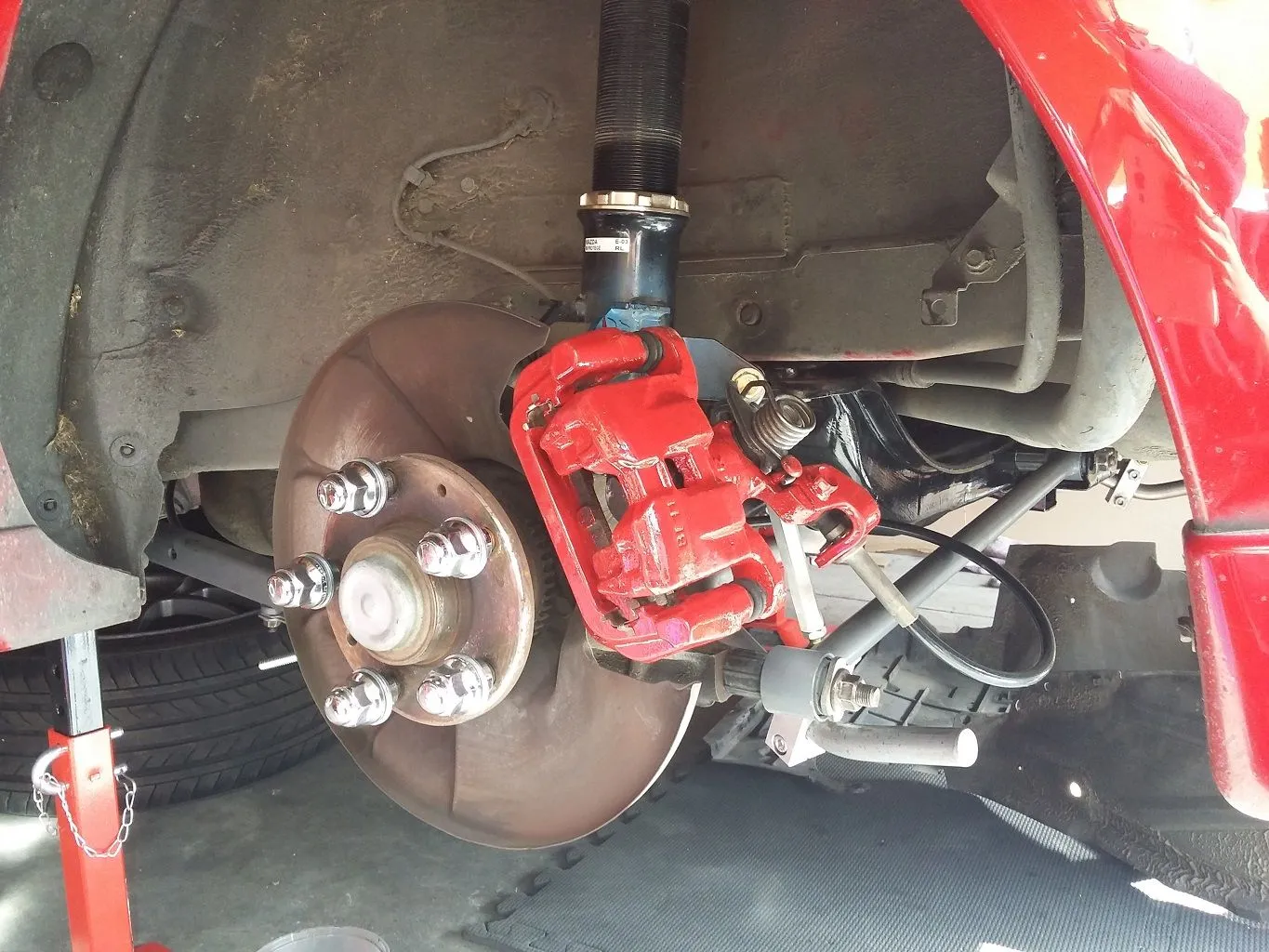

I'm pretty sure that those were the ones where our stock cables are too short.
The bracket that the p-brake attaches to is facing a different direction on the 626 calipers and our brake cable isn't long enough to swoop around and connect to it.
It's the part on the bottom left of this picture.
I remember one guy just used a bunch of zip ties to attach the end of the cable to the frame or something and it did sorta work but not too reliably.
The whole cable would move when he applied the p-brake.
Keep in mind that I'm not 100 percent sure about the details.

Front brakes are simples, bolt straight up and use all the standard lines. You've got 3 options, GY, GH and Speed6 versions (280, 300, 320mm disks from memory) GH and Speed6 require 17" wheels
Rears are more complicated. I used GH mazda6 calipers and rotors which bolted up but did need custom p-brake cables (350mm longer from memory)
Good luck, there's lots of info floating around about this conversion so it can be a bit confusing!

They wouldn't work reversed, because the bleeder nipple would be facing downward and would leave an air bubble.
You wouldn't flip it upside down, you'd rotate it horizontally a bit like this... (sort of..)
As long as all the bolt holes line up but they should?
You could flip them over and make an extension for the bleed nipple to get it up above the caliper, it'd be a bunch of effort but it should work. I think I tried swapping the calipers side-to-side and the p brake cable ended up at a weird angle (It's got to come over the top super close to the strut)
If anyone wants I can whip these off and swap them over tomorrow to snap a pic
