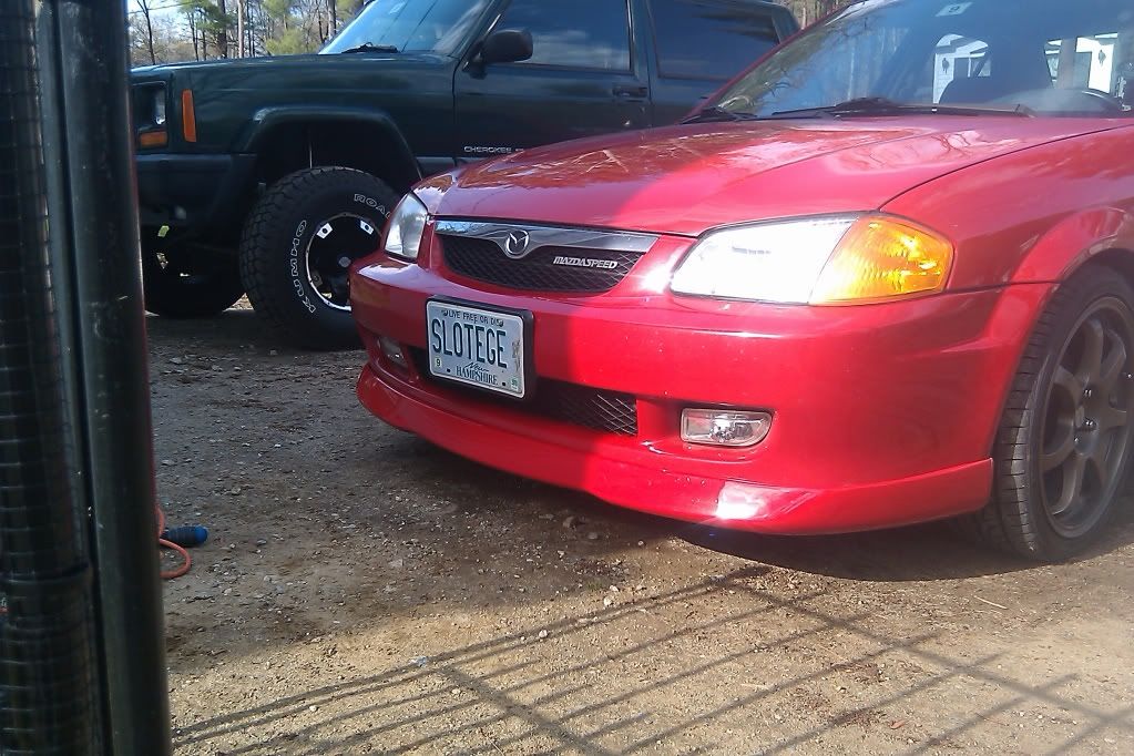

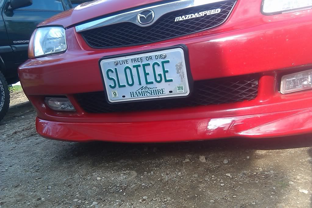

How did you make the lower grill to match? I won't ask about the sedan lip cuz I know they're super rare. But are the fogs a factory item or ebay peices?
hate the size rim i bought Think im going to sell them brand new tire only like 4 weeks old but looking for a body kit/wing/need headlights
the grill is probably a lower grill front a p5 or speed that has been cuted to fit the hole.
correct-o, and the fog lights i got on ebay but was a factory kit, the guy had a lot of like 5 kits. Came with housings, harness, switch, relay, and Mazda dealer instructions.

yeah its a good idea i think ;)...and for snowy days when im out playing in parking lots, it prevents a lot of snow and ice build up on the a/c condenser and radiator, it just gets stuck on the grill and with a swipe of my hand it clear and the radiator has air flow again also fills in a space i think is goofy looking on the 99-00

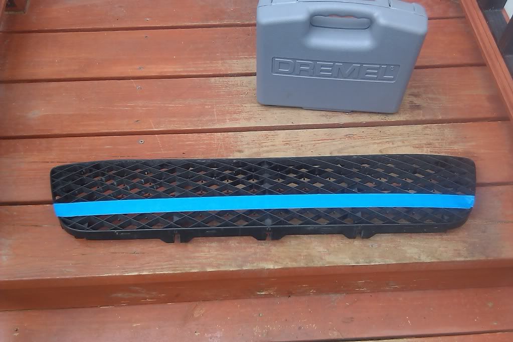

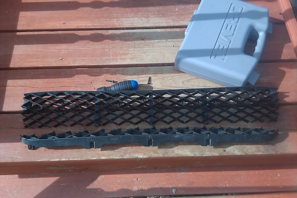

did you use zipties to put it on the bumper?
two screws that screw into the bumper cover on the top part of the grille, then two zip ties around the "supports" on the grille to the "supports" in the grille space on the bumper cover, so looking at it u cant see the zip ties or the screws
It was really simple, dremel with a cutting wheel and just take ur time and dont cut too much, test fit frequently as your cutting. Also, as u see the bring cut along the bottom i used tape to make sire i cut straight, a very good tip for anyone trying.
