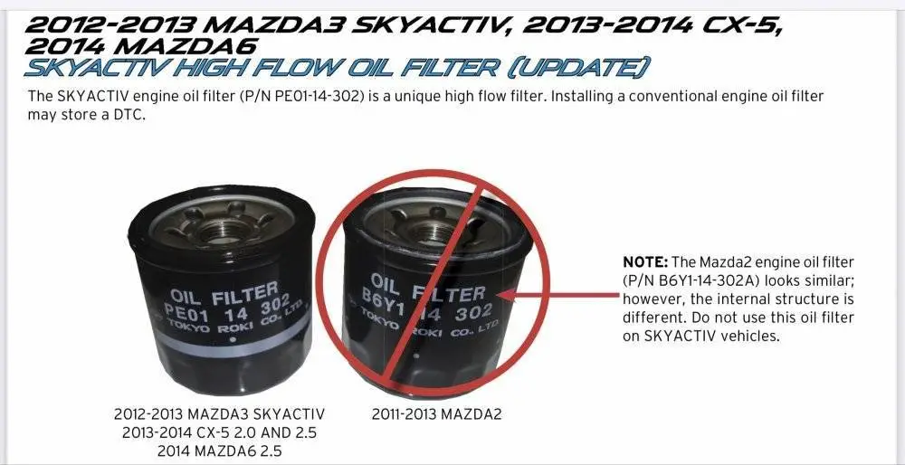

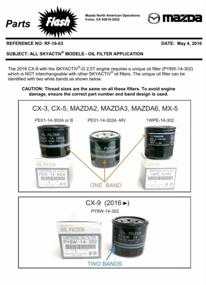

Here’re a couple of oil filter documents from Mazda:

There’re 2 different OEM Thai made oil filters for the 2.5L and the 2.5T. In US, Mazda had superseded Japanese made Tokyo Roki oil filters installed in factory by Thai made OEM Denso oil filters.
Mazda OEM oil filter part numbers:
Mazda2 1.5L:
B6Y1-14-302A.
Mazda CX-5 2.5L NA:
PE01-14-302A (Japan) / PE01-14-302B (Japan) ->
1WPE-14-302 (Thailand) / PE01-14-302A-MV (Mexico).
Mazda CX-9 / CX-5 2.5T:
PY8W-14-302 (Japan) ->
1WPY-14-302 (Thailand) / PY8W-14-302-MV (Mexico).
Mazda recommends 0W-20 oil for the 2.5L NA in the US, but Mazda also recommends optional 5W-30 oil worldwide.
And Mazda recommends 5W-30 oil for the 2.5T.
Like I mentioned before you can get Japanese Tokyo Roki PY8W-14-302 oil filter directly from partsouq.com website or the same seller partsouq on eBay. But be aware most US online sellers will ship PY8W-14-302-MV or 1WPY-14-302 even if you ordered PY8W-14-302.
