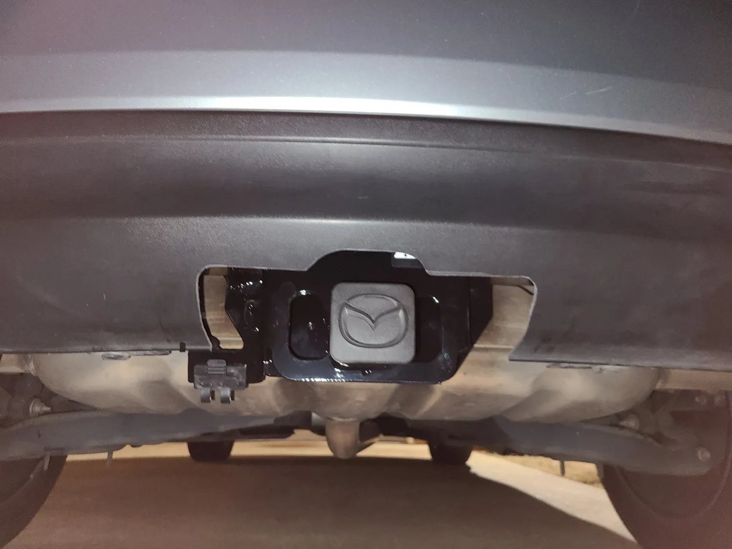

I just installed the OEM hitch and wiring harness on my CX-5. I can definitely confirm that there is no receiver. FWIW, I really prefer the look of the OEM hitch to the aftermarket hitches which hang down below the bumper cover, but Chas makes good points about the 1.25" receiver limiting some choices.
Upvote 0
It is unfortunate the aftermarket hitches reduce ground clearance a little. A lot of SUVs have an accommodation in the plastic bumper cover for a hitch. Did you have to cut the bumper?
Upvote 0

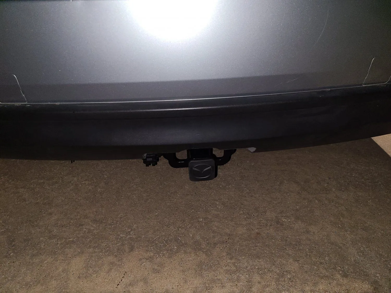

You will have to cut the bumper to install the OEM bumper. I used a jig saw with a scroll blade designed for cutting laminate. I imagine that any fine toothed scroll blade would work though. Cutting a bumper is nerve-racking. Last time I tried, I found it difficult to un-cut something. It came out fine though. The parts come with a template. You barely notice it's cut from a standing position. I took a picture from down low to show the cut better. One thing I'm curious about is the '16 template was a smaller cutout than '17 and up. I assume for chain clearance and wires, but the smaller hole would've looked better, I think.

It looks like the scroll saw works great. Smaller might even look better but you are probably right about the chains.

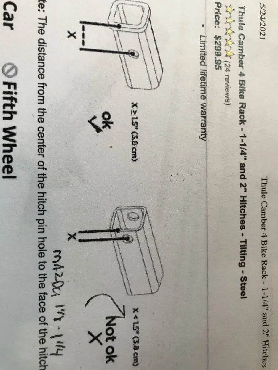

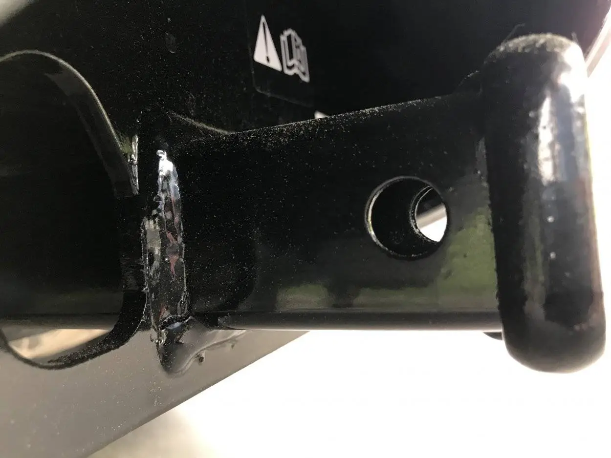

Adding to this chain. I have a 2021 cx9 with the Mazda factory hitch - I need a 3-4 hanging bike rack but almost all the instructions say the hole from the face of the plate needs to be minimum 1.5 inches centered. See photo . The Mazda hole is 1.125-1.25 - see photo. Does this really matter? Does anyone have a bike rack brand that works already? Any replies would be greatly appreciate!

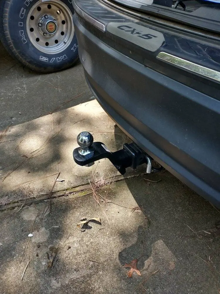

I installed a Curt 2" myself, (I promise, it's not hard at all), and it was all of $130! Add $30 for the wiring harness that's plug and play into your brake lights, and we are still far, far under $200.
Oh, and no cutting of the bumper cover, either.
Yes you lose a little ground clearance, but that's easy to remedy, you simply get a 2" drop receiver, and flip it over, making it a 2" raised receiver. Back in business.

The hitch receiver drops down about 2.5 inches below the bumper. That's ground clearance you might want driving up a very steep drive or slope.
Flipping the ball hitch will have an effect on levelling the trailer ( or not) but you still have reduced ground clearance because of the hitch.
I figure if that becomes a problem I could remove the Curt hitch and cut the bumper cover to install a factory OEM hitch.
So far not really a problem, but there are scratch marks on the bottom of the Curt hitch.
