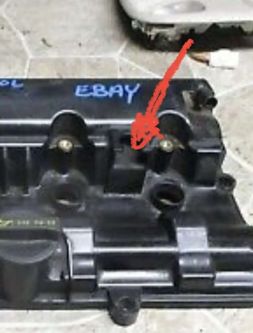

Hi , had the p0171 code.. looking for leaks in all pipes.. nothing.
At the end one of the engine cover insulator was missing causing the pin to get in contact with the
Valve cover and create a small crack with a hole … .. where the red arrow is…
