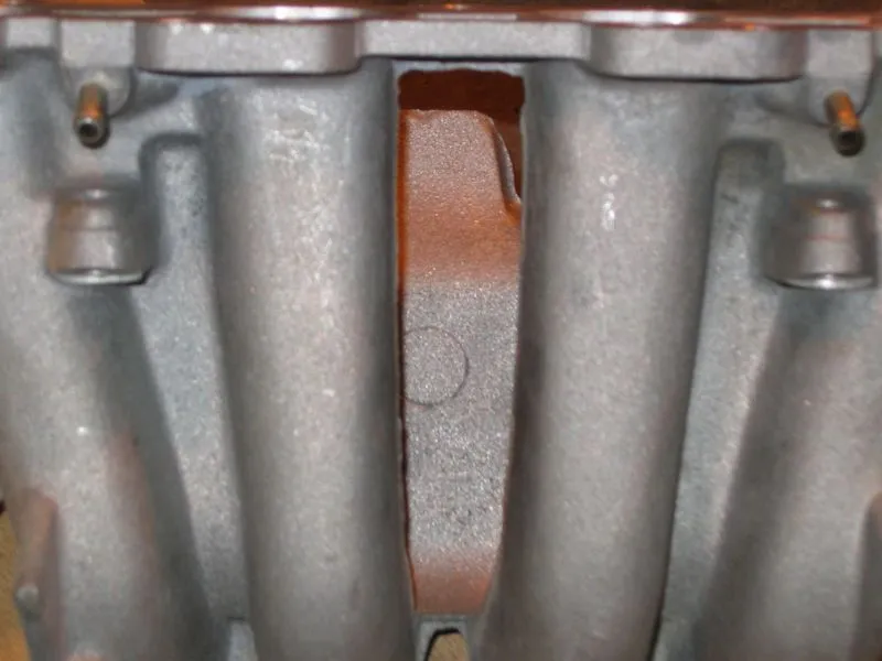

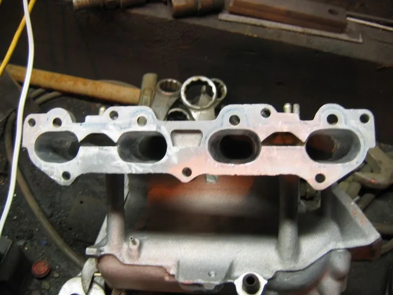

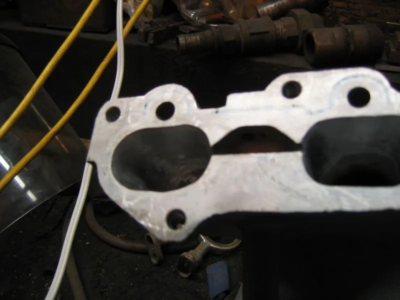

The mani has now been nicely ported and lightly polished (by me Josh and Harley).
I plan on scoring the runners and repainting it before attempting another install.
So got the stock mani off but had to torch the stock EGR pipe to remove it.
I put a gasket on the head to see if there was much gap / overlap that could be ported and there does not seen to be much if any. I used the gasket as my guide for porting the runners. So they should match up well.

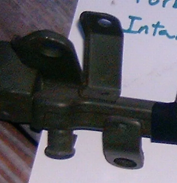

1. My Fuel rail mounting tabs were nowhere near the 626 mani's.
According to Jason at Montgomery Mazda:
Before 7/03 production part # FS7E 13150A $90
rear mounting tab/bracket should say "FS7E"
After 7/03 part# FP49 13150C - upgraded fuel rail.

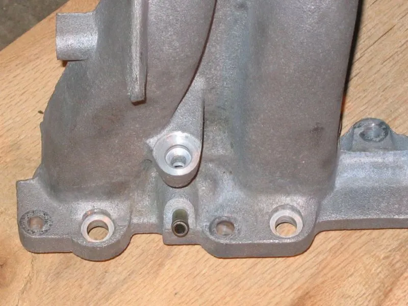

2. Injectors appear significantly "recessed" when in place in the 626 mani, on the stock mani they appear to be flush.
3. EGR tube supplied with SU mani was not lined up to OBX header OR 626 Mani outlet...ARGH!!! Copper tube temporarily in place.
4. Once in place WITH an NSN mani SPACER and 2 gaskets, stock studs and hardware appear to be too short. Some thread can catch but not enough for me. One shorter bolt stripped some thread out of one of the spots.
5. Rear support brace on back of 626 mani is about 2 or 3 inches further from the stock mounting point. This is only lining up on 1 of the 2 bolt holes and requires a longer bolt.

Pics
Some pics of the ported runners and different fuel rail mounting points

exoticracr said:
looks like your fuel rail holes are supposed to be spread out more from the middle based on theirs
ur pic looks like the 2 inside brackets on the stock fuel rail would line up.
Notice in my pic that the mounts are like 90 deg out of phase?
