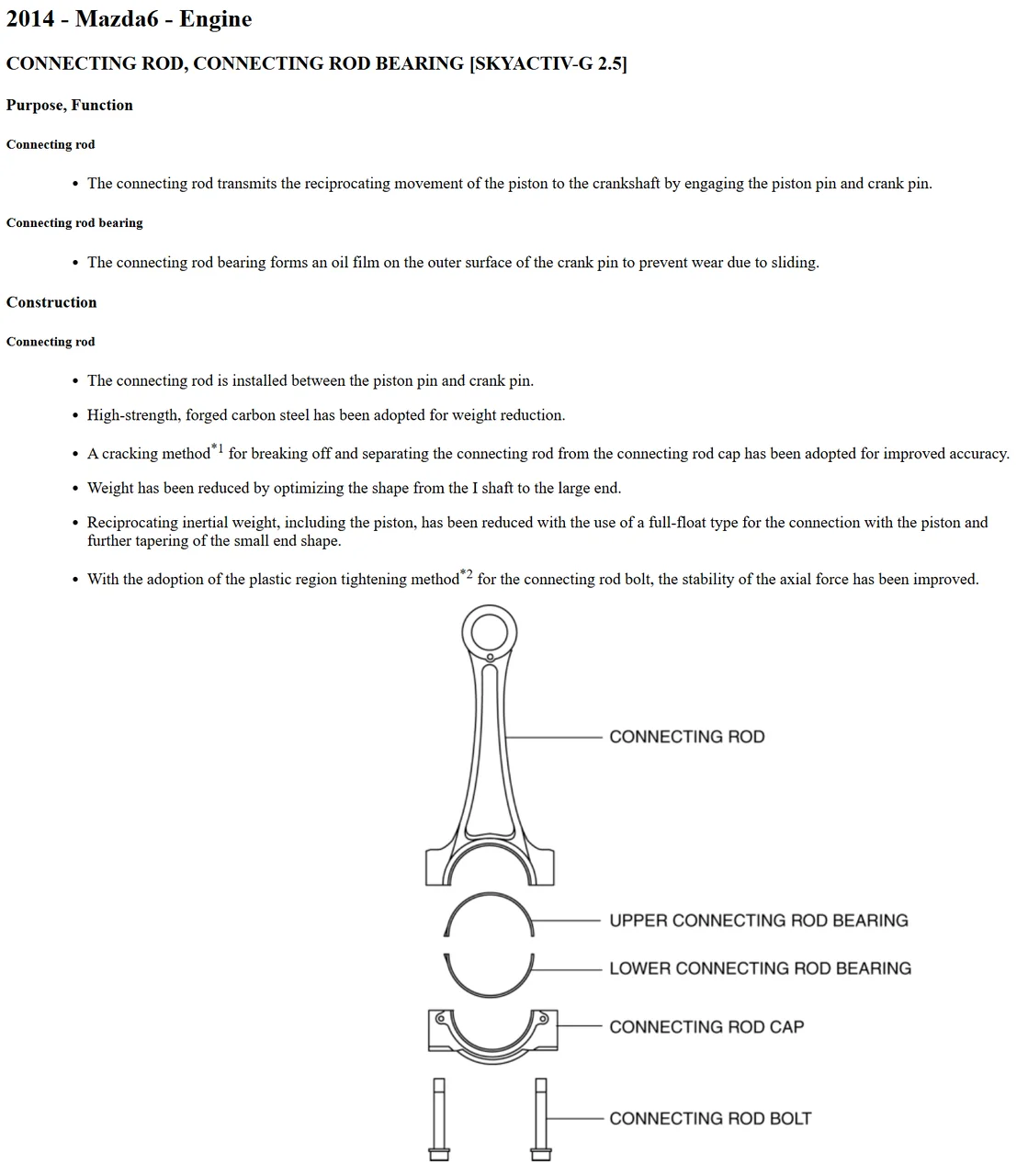

this would indicate there is no difference in at least some parts. looks like somethings like valves could be different but crank looks the same and pistons etc. I know the tranny is different according to some of sinistriel@'s excellent posts.
