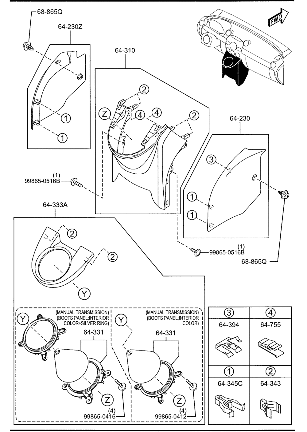

You're likely not going to find one specific to automatics. Either you will need to spend a few hundred dollars on a Factory Service Manual, or pull off what you can and figure out how it's attached. Removing the black trim ring and the lower console cover is the same, then it's going to be observation. Remember, every part was assembled, it can be disassembled.
You can easily remove the black plastic shroud that surrounds that part by using a screw driver. See where that gets you, then go from there.
Looks like the trim surround pops off like the manuals but without the boot.
