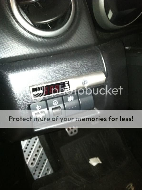

w/ 25k mileage just make sure it doesn't appear to be modded, buying a MAZDASPEED car used is fairly risky in itself IMO - but one with damage and possibly modded, stay away.

the main problem mods would be dodgy tunes, down pipes, and manual boost controllers. those, especially the first and last, can really **** up an engine. if you can bring it to a dealer and have them check it over with these items in mind, that would be ideal. they should be able to check the ecu and know where to look for the mbc.

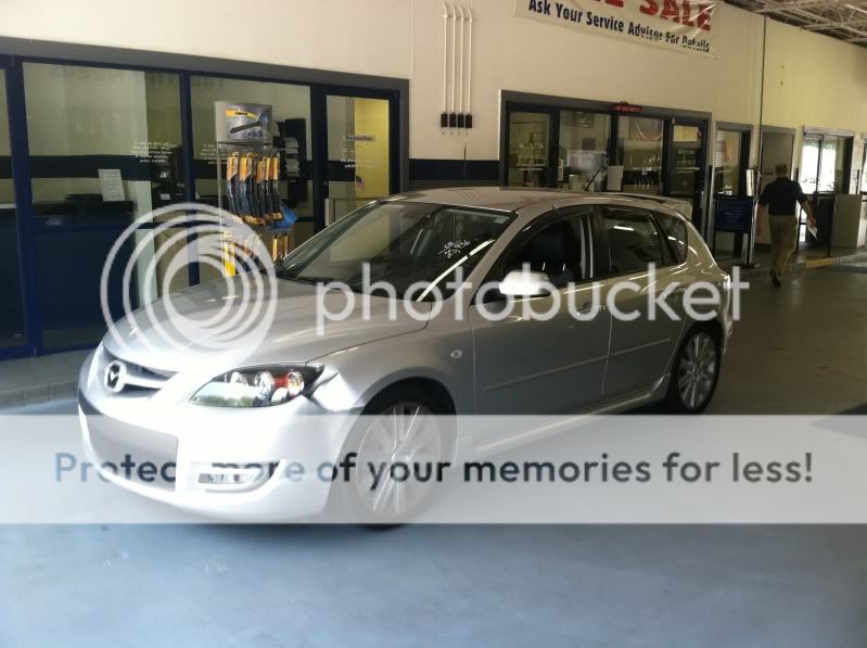

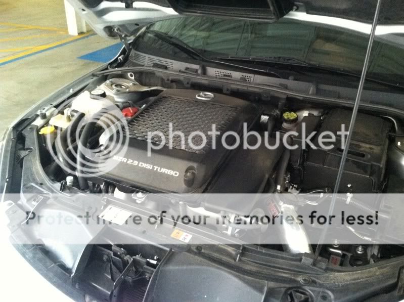

When we got the car in and I started looking it over, i noticed that the dome lights werent working, neither was the keyless entry, the turbo timer, the radio, or nav. So I got them to let me take it home for the weekend(just turned it in today and I have to have this thing). Got it home started looking at all the fuses. Sure enough the fuse for the dome lights under the hood was blown. Swapped the fuse for the fog lights for the the blown one and everything came back on. No big deal problem solved.

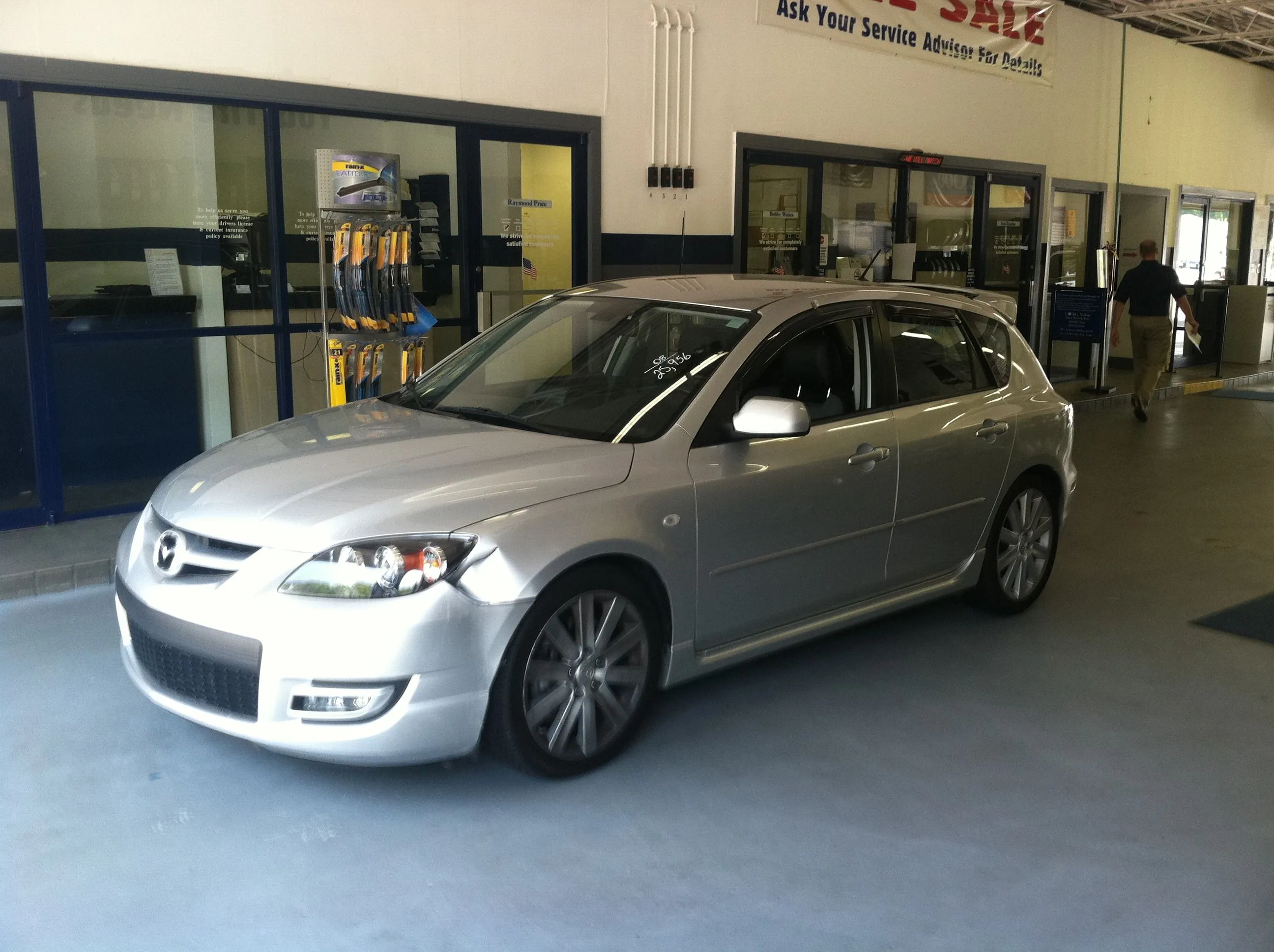

Depending on what's going on under neath it may even be possible to save that fender. It might not look perfect but could potentially be much cheaper than a full replacement.
