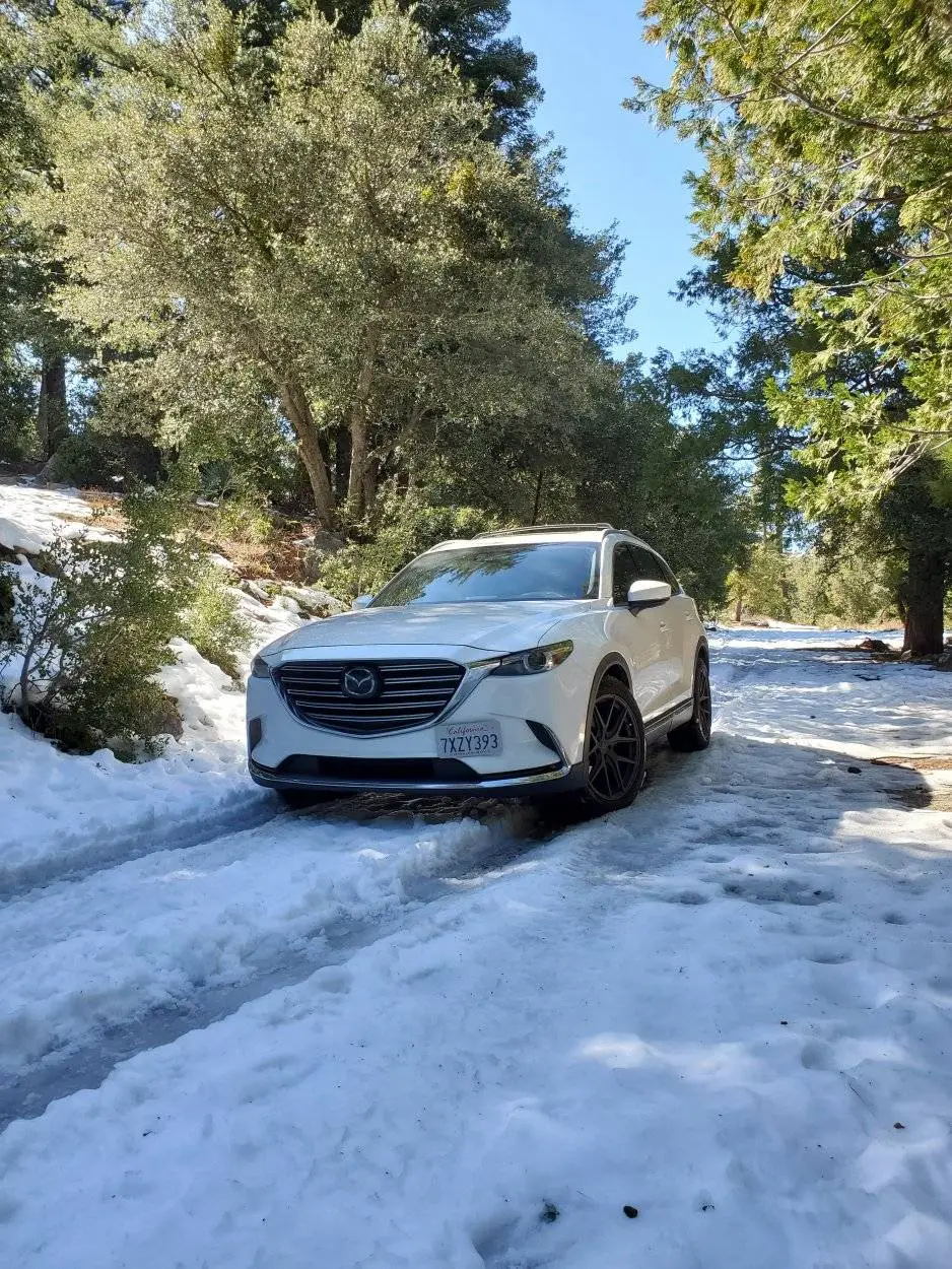

For reference, I have 20x9.5 +25 with 255/50/20 and there is still wiggle room for "flushness". Also when you shop for wheels, make sure they have proper load ratings for suv.
Based on this setup, I think 9.5" width with a +20 offset would be perfect for you @danmm7.
