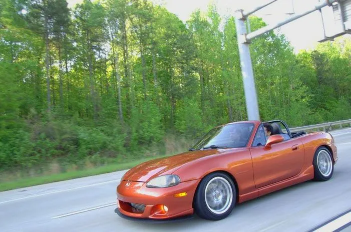

Those are actually what are called the large side sills. The small ones are like what I have on my car (main difference is the front doesn't climb up the fender).
attachment.php
you're right...
I like the smaller side skirts better. Like, a lot. And I also don't get people's fascination with mud guards (and car-bras... but that's a different story altogether)
the mud guards are nice mazda pieces...not rubber flaps...well i like them and i thin they'll look awesome with the sills
