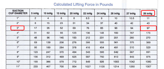

no protectant will help with the indent, the texture of the soft touch plastic was compressed beyond it's yield limit and flattened, trying to fix it with WD-40, alcohol, etc will be ineffective and just make it worse, for now just have to leave it alone and eventually it should just return to its original form with time if you didn;t use the mount that long.....
I found online that some people had the indent just after a few minutes, you be amazed how much force is applied with those damn sunctions.. especially the ones with the screw dial....
close to 97 lbs pounds!!! of pressure was applied to that small area on your dash (assuming a 3" diameter suction cup)
no wonder the plastic dash is flattened (the molded plastic "fake" grain texture/veins was flattened and most likely cannot be fixed to it's original molding texture and the center untouched area where the sunction didn't touch was vacuum pulling up the dash
standard atmospheric pressure (1 atm = 29.92 inHg)
