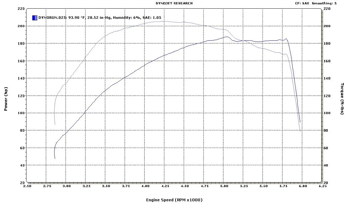

ok, here are some independantly conducted dynographs of the MAM Street Sleeper kit:
dynorun025 is at 6psi, GT28r (current kit is a GT28rs or GT2871R), MPI tuned, with stick midpipe (with stock cat), a 2.25" magnaflow cat back exhaust, and a 2.25" downpipe (current kit comes with a 2.5" downpipe) also the current kit comes with a MAM midpipe which would improve spool times and power as well.
dynorun026 is at 11psi, same parts as at 6psi, all A/F ratios were in the optimal range, but you can see where the rod went through the block (good reason to go forged), but notice how fast the numbers were still climbing at the time of the critical failure. by the way it blew up at 4300 rpms
Beau should have some more up to date numbers soon after his dyno day coming up.

dynorun025 is at 6psi, MPI tuned, with stick midpipe (with stock cat), a 2.25" magnaflow cat back exhaust, and a 2.25" downpipe (current kit comes with a 2.5" downpipe) also the current kit comes with a MAM midpipe which would improve spool times and power as well.
This run was done with a stock midpipe and stock cat.Only mod was a 2.25" Magnaflow catback and it put down 186whp.This run was done with a GT28R as well..We will be dynoing our Sleeper kit with a GT28RS in 2 weeks for our anual dyno day.
Since this dyno graph here, we now use a 2.5" downpipe and a GT28RS.So I would expect the numbers to be around 200whp at 7psi and 5500RPM's.
