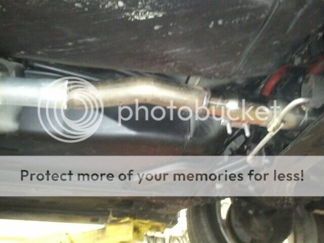

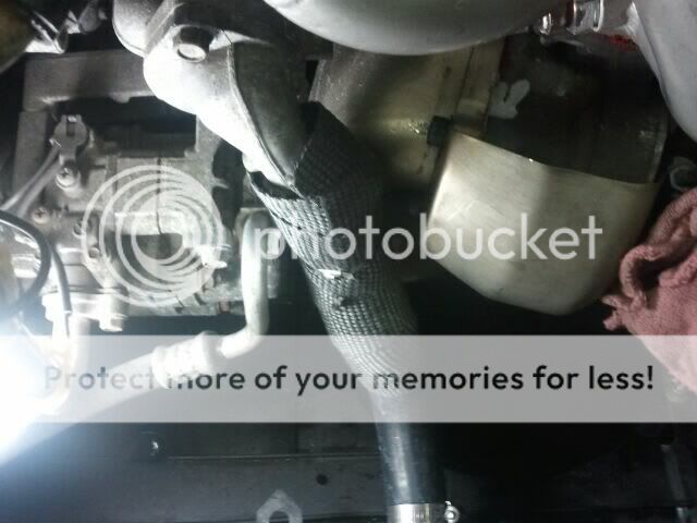

Finally got around to putting it all in. Taking everything out went good. All came apart nice. The install. The turbo to mam mani went on good, the pope down pipe fits terrible, did they ever test fit it?
They could have made it so you can get a bolt or the nuts back on to hold it together. Then when installed on car, the pipe points up too far toward the oil pan. I was able to make it work. I bought a downpipe from ebay for a civic just to get the flex section and O2 bung. Anyway gotta finish the exhaust today. The O2 bung on the mam mani is on the other side of where it normally goes so I have to lengthen the wires for that today also.

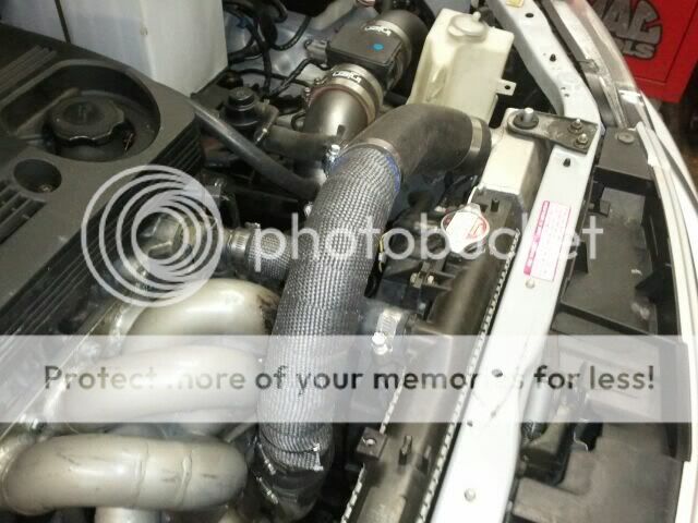

The Hot Pipe sits on the manifold so im going to have to get a hard one made that doesnt sit so close.
I agree on the FMIC, thats a nice setup man. I think the Pope didn't fit because the MAM mani moved the turbo from the stock location.
I think the mam t2 is the same as oem... its the t3 that shifts it. My Pope dp wasnt bad even with an awr pan allen bolts would have maybe been easier too... a little more clearance. Also your lower radiator hose is gonna cook there... need a straight t-housing and different hose like speedcircuit sells or make a spacer or something.

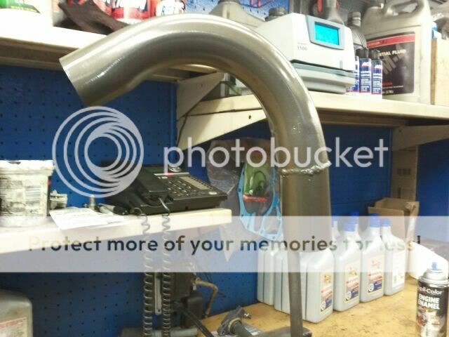

I will have to look into that, so I cooked the samco hot pipe today on my way to work to finish up the job. So today, I put the stiffer spring into the forge wastegate, boosting at 10psi now, wow what a different from the 5-6 I was getting. I mated the rest of the exhaust, wrapped the rad hoses in heat wrap till I can get the different housing, and made a new hot pipe.
For the hot pipe, I used some exhaust pipe then cut the samco to fit.

True but since the MAM manis were all custom made by hand there are differences in the way they are each made. Yes it is supposed to keep the turbo in the stock location but it probably isn't perfect and moved it just enough to make the DP interfere with the oil pan.
