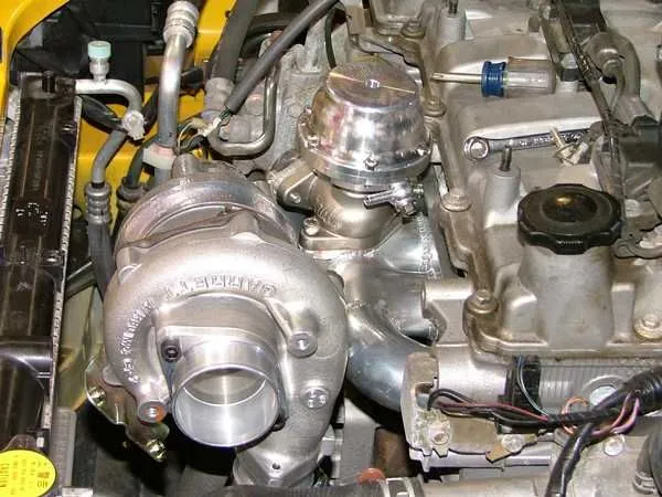

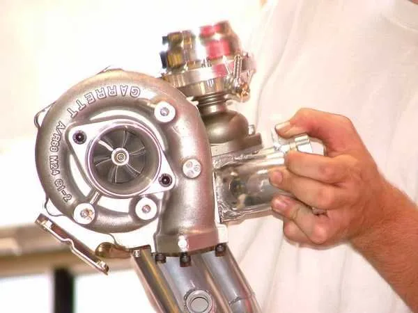

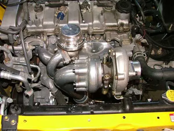

The kit is very near completion. We are hopefully going to crank her up today (Sunday) and get it mildly tuned, and do a few misc last things.
Here are pics from today. We worked from about 11am-1am.
