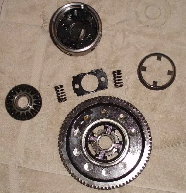

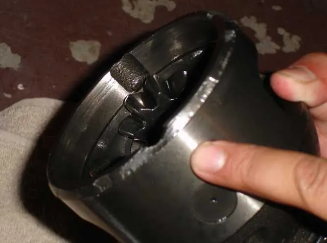

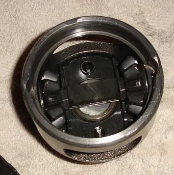

Add me to the list Orng1 at about 44k miles.
Here are some pics.
The whole diff. dissasembled
attachment.php
attachment.php
Here is where it breaks at the 4 spot welds.
attachment.php

pics uploaded for orng1
Thanks Sam, I wanted everyone to see what goes on when the diff breaks. There is alot of pieces that can damage your transmission. I got lucky, I thought the clutch had gone with mine. It still drove but it felt as the clutch was not holding any power it just spun, if I reved it to high it could just spin so I babied it to a gas station and had it towed to my house then in the morning I drove about a mile to a friends house (some guy in an integra tried to race me cause I had my e-lights going what a moron). You can see in the first pic all the pieces broken down from the diff, the rivets that need to be drilled off or grinded however you do it the 2nd pic is the inside of the diff and the gears, then the last pic I thought I would show the spot where it breaks (above of my broken finger) from the weld spots where it broke. Good Luck to everyone else I hope this doesn't happen to any other person. Sorry it got long.
Orng1/Bob
thanks for the pics. i asked the dealer to keep my OEM one out so i could see it and photograph it. They said they would, but they forgot to nor did I pursue it.
Thanks for posting the pics. Now I can clearly see what is contributing to these failures. Two of the four places they welded have almost no meat to weld to! Check out the rounded indentions on the inside with the welds right on top of those areas.
