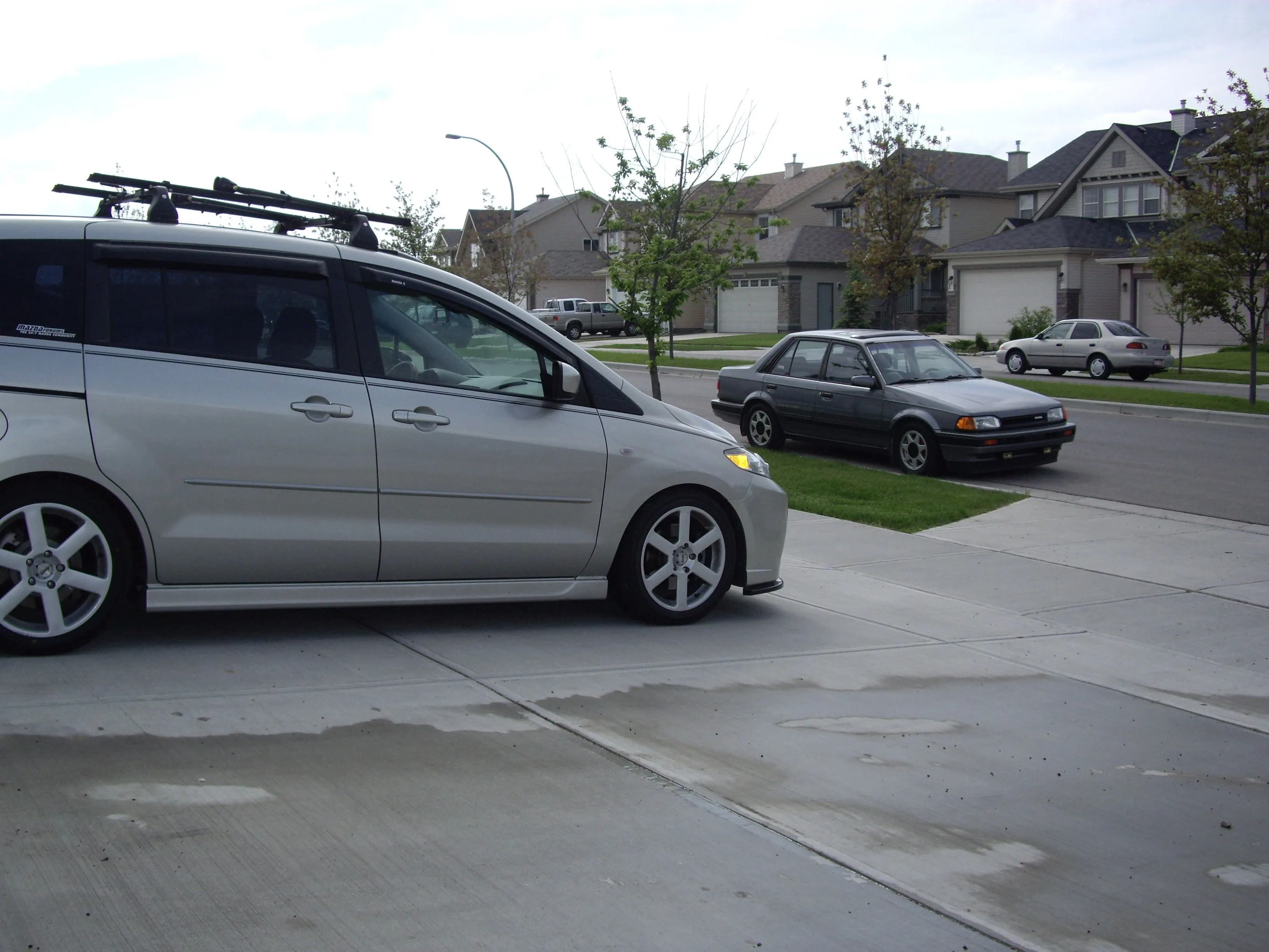

lowering springs for mazda5?
is there any out there? How about a pic of lowered mazda5?
Lowered using H&R springs.....I cannot say whether these springs are made specifically for the '5' or whether these are the same as the '3'. I placed an order for Mazda 5 springs.

they are specific to the mazda5. h&r is the only company that makes mazda5 specific springs, although the 3 springs will technically work.

Anyone have issues with Camber, especially in the rear, after lowering their 5?
Yes...with the H&R springs I had big time negative camber in the rear.
I used the MazdaSpeed camber adjustment plates to bring this back in alignment. The dealer used the mazdaspeed camber adjustment plates for the Mazda3...Cost me a bundle but it definitely straigntened out the negative camber issue.
Anthony

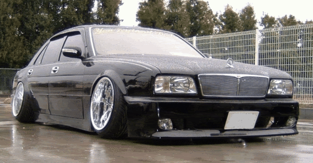

Typically, the camber issue is an overseas problem. Just keep the correct psi, and rotate often, and you'll be fine.
What?!
What makes lowering a vehicle 'overseas' any different to lowering a vehicle i north america?? (uhm)
And if you'retalking about this camber...
...it didn't happen by accident because the guy lowered his car.
That camber is intentional.
What?!
VIP Style is what they call that...
