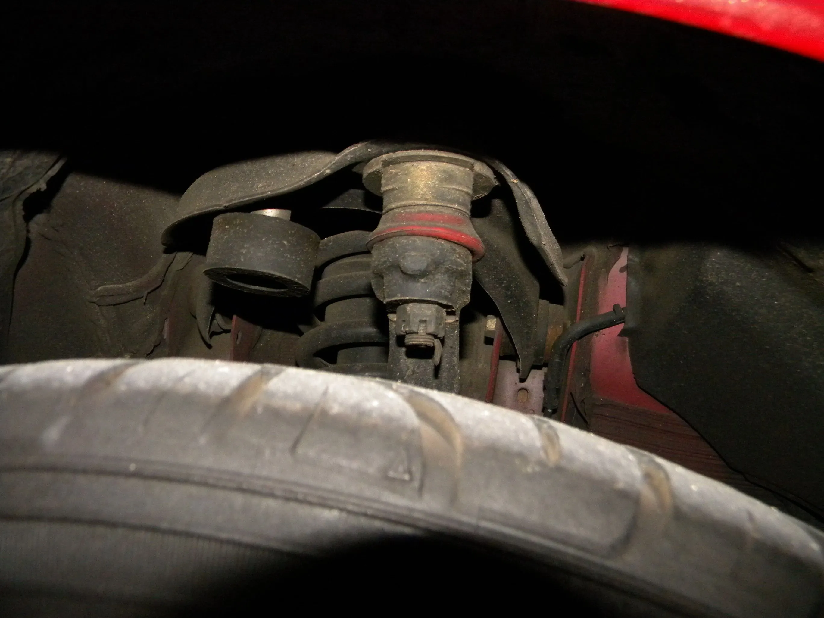

I'm not going to lie to you, I have done very little suspension work before im not familiar with a lot of things so this brought my attention. If you look at the image I have taken this object it looks like a ball joint I believe its directly below my tire. If I lowered it would I experience any problems such as rubbing or will this go threw my tire?
