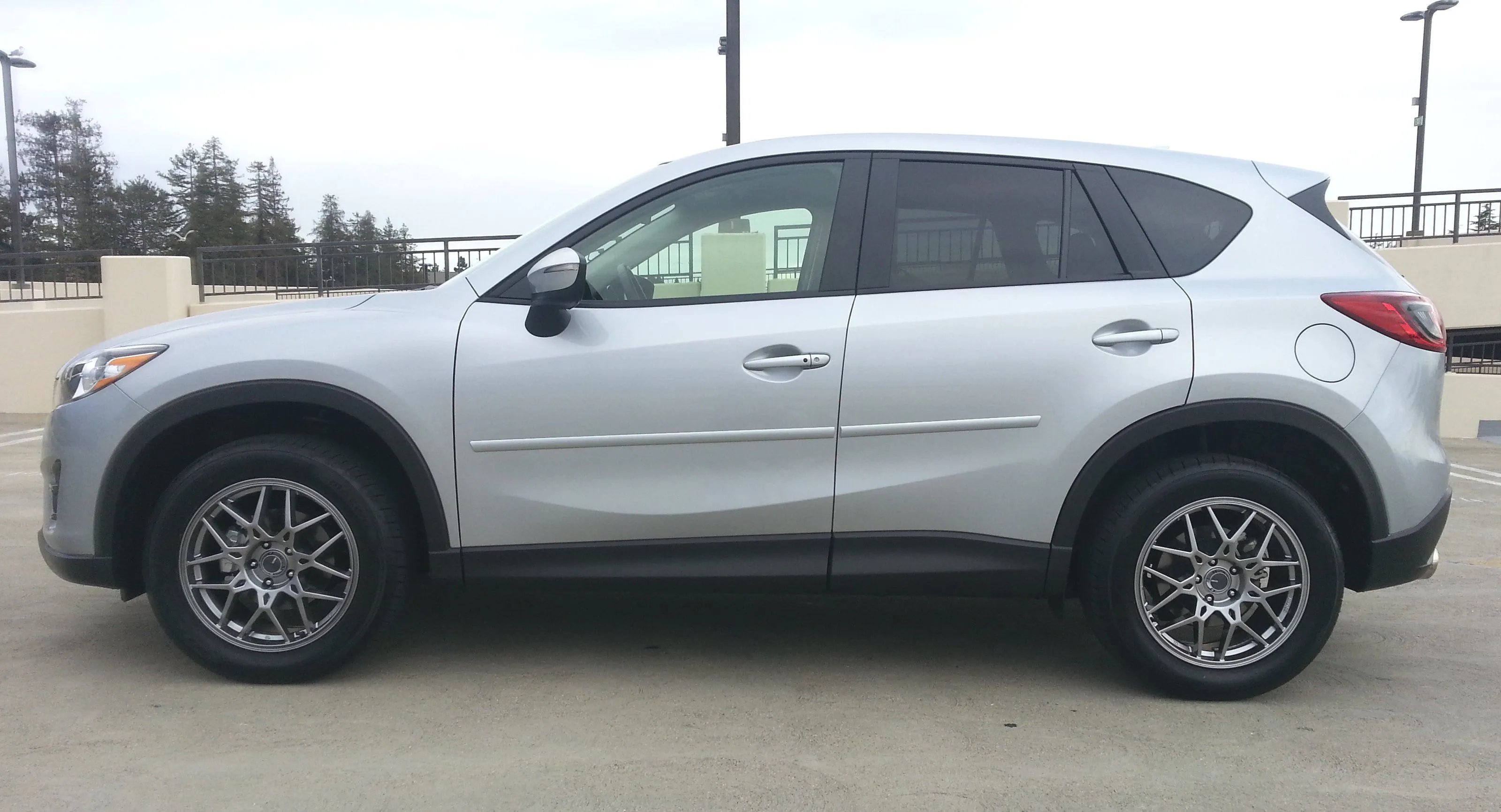

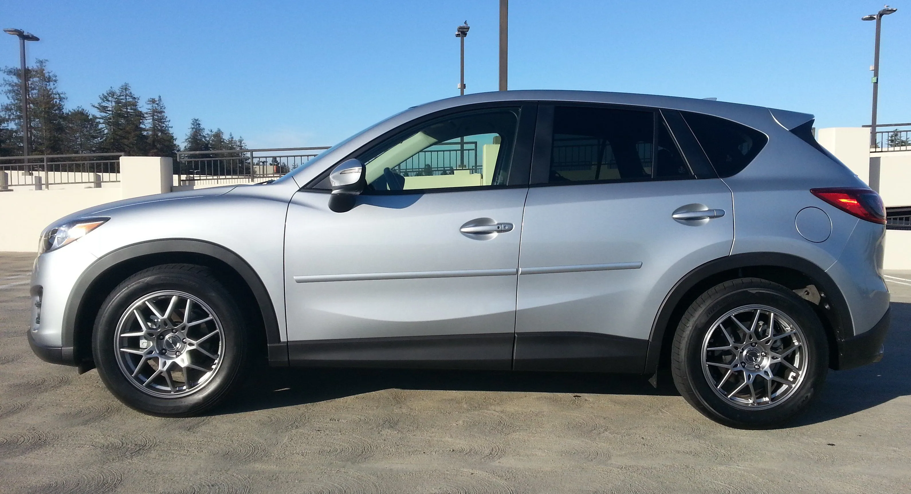

Eibachs, rear camber arms, and front camber bolts installed. Very pleased. Perfect height, ride slightly stiffer than stock, roll in corners reduced. Springs do not overwhelm the stock shocks and struts.
Before:
After:

Looks good; drop appears to be more or less comparable to H&Rs. I also like your wheels. Matching them to body color works well.

I should've measured before/after. Thanks; looked at a lot of wheels before pulling the trigger. They're 18 x 8, 40mm offset, with a 245/55 tire. OD is virtually the same as the original 17s, and they fill out the wheel wells just right.
