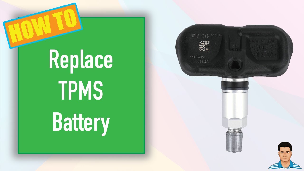

Maybe one of your tire sensor (inside) is failing ... low battery.
FYI.
Look messy. I'd just get a new one.
The silicone is there to make it water-proof.
Have most people here with a CX5 replaced their TPMS battery after a certain number of years? Have not seen that talked about here. I noticed in the manual it says a blinking low pressure light means the battery is low but mine was not blinking.
Thanks for the link...will check it out.
Looking at that video I doubt anyone is replacing the battery! Has anyone here had their battery fail in the sensor in their CX5?
Some people probably have and did not know it. Most tire places will add it to the tire installation and many people do not notice.
I'm pretty sure the batteries in TPMS sensors are encapsulated and not replacable.
