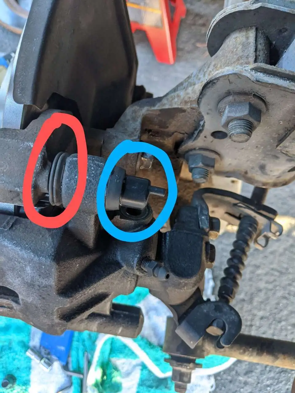

While doing a brake job on my P5 I noticed that a few seals were missing or damaged. The accordion boot (name?), circled in red on the top shaft of the front caliper was missing a chunk, letting in a bunch of dirt. I think this caused the caliper to pad to wear unevenly (1mm difference side to side).
That caliper was also missing the cap for the other shaft (the one you unscrew). It's the same as the one circled in blue below.
Is it possible to replace either of these without getting an entire new caliper?
(eagle eyes will note that this is a rear caliper...)

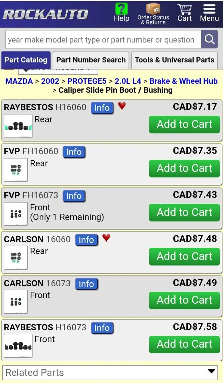

Rockauto has them too.
