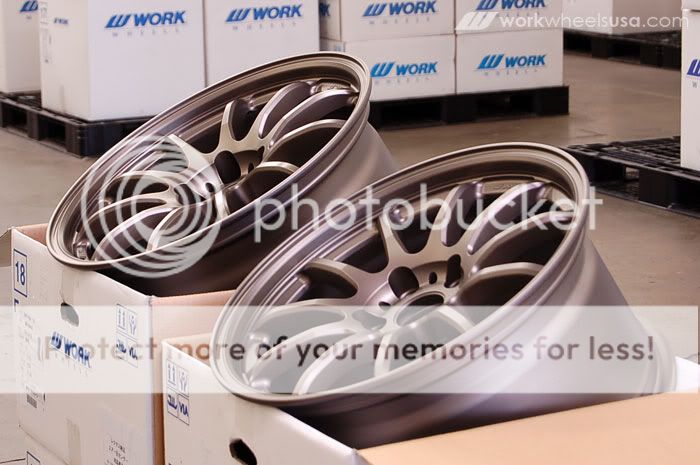

Im having a hard time choosing between work wheels. I can either go with
work XD9
18 x 9 +38F /maybe a 10mm spacer
18 x 10 +38R /maybe a 5mm spacer

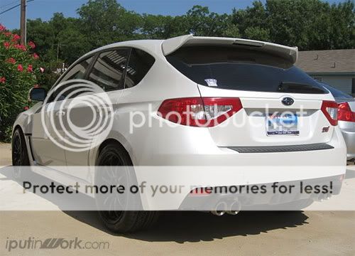

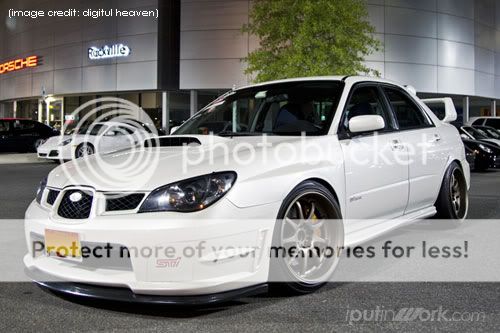

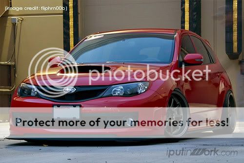

kinda like this
or try and squeeze 18 x 10 +38 all the way around with using the minimum spacers needed, like this
opinions please
i looked into those, but im shying away from a 5 spoke. Ive even considered going 17 x 9.5 +38 XD9s. Just because the 18s dont come in a 9.5 width, and the lip on the 17 is almost as big as the 18 x 10

Ok, so I spoke to the distributer just now and have come to thid dilemma. I can go with
Xd9
18 x 9 +38 fronts w/ 45mm lip w/ 5mm spacer
18 x 10 +38 rear w/ 73mm lip
Or
17 x 9.5 +38 all around w/ 68mm lip
Yes, the 17 seems to be small to me too. That's what makes this choice hard. Fender work vs lower suspension mods. Ill be ordering this afternoon. Please post up your opinions/knowledge. Thanks
If youre going with x9, try to space it out to atleast +30 effectively. +38 is significantly less agressive than the other choices
the 9.5" width evens them out. Its a combo of offset/width that determins actual poke. Check out this site... www.willtheyfit.com . Here are some of size comparisons with the wheels ive had and ones im looking at buying
