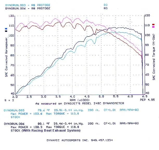

its usually about 104whp and 113wtrq on average.
my times are near stock. i only went to 6000rpms and didn't launch really hard. i only had the intake,wires and exhaust on at the time. im sure if i ran it now i'd be about a mid 16 which is sad.
I dynoed at 101whp and 111trq with a cold air intake. My 1/4 was a 16/8@81mph.... thats with a bad 60 foot. With i/h/e, the average P5 will run a 16.6@81mph. There isn't much to look forward to at the drag strip with a P5...

What sucks is how bad the power delivery is on an FS-DE. The dyno is all spikey. Mine was like that too....actually, almost every single P5 dynos ive seen looks all choppy like that...

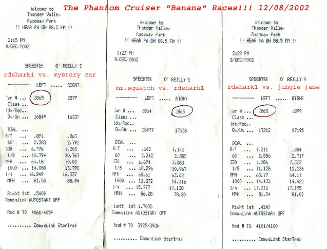

There's my stock dyno. Lovely, isn't it?
Stock I ran a 16.84 @ 81.50 Blazing fury, no?

it looks spikey because of the increments used. if the increments were larger it would look less spikey. every car is gunna look spikey when the increments are smaller. our torque is relatively flat for the type of car we have.
My Dyno:
will have to get a better one up later......
max HP was 113.XX and TQ was 116.XX
the runs were getting better each time as the engine was warmer!
-R
