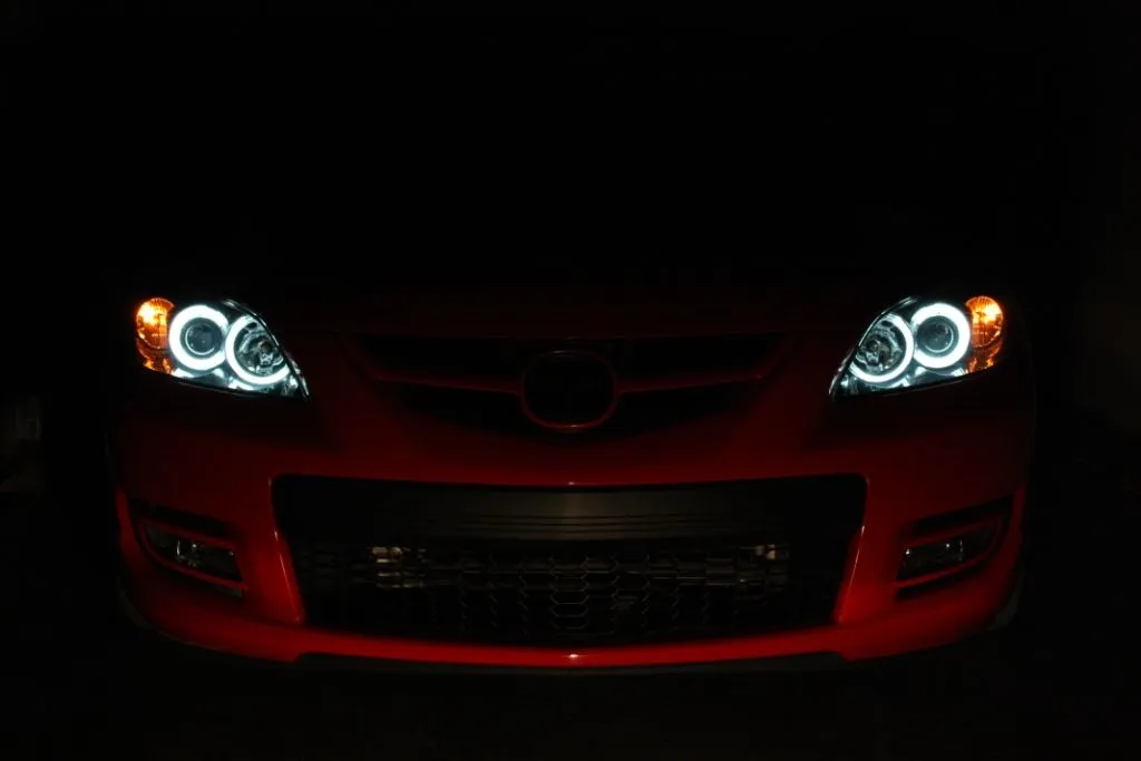

No, not really. Do you have a GT model MS3? Mine was a sport and came with halogen headlights, so I upgraded to the better ones.
I've heard excellent things about the clear lenses....I wish I would've gotten those when I did my halos as well.
Good luck!
i love my ddm halos. good luck on the instal

did you have to bake your headlights and all that jazz for the halo's?? also how was the install pretty straight forward?
yup.. start to finish took 8 hours to do HIDS and halos...wiring both was time consuming
225 degrees Farenheit
8 minutes
place aluminum foil on the rack positioned in the center
i decided not to bake mine. sometimes that can make the lenses all rainbowy and burnt. i used a heat gun and carefully pried them apart. i would also suggest using some type of epoxy to hold the halos in place. the tape they give you sucks
