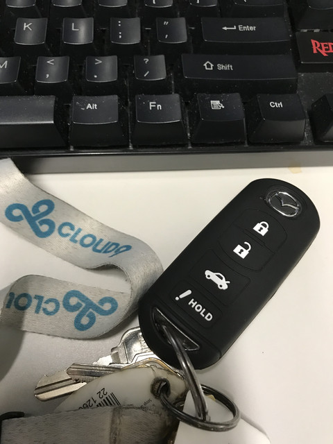

my key just stays with me, i've had a cx5 for over 2 years and never once had an issue with the key. sometimes i forget the keys in the center console and when I walk away, I notice the car doesn't auto lock like it would if my keys were on me, so I go back and get my keys. usually the problem is me leaving it unlocked, not locking myself out. i got a nice silicone case for my keyfob and i just attached it to my keyring with a lanyard. the keys stay around my neck if i don't have pockets or in my pocket if i do
