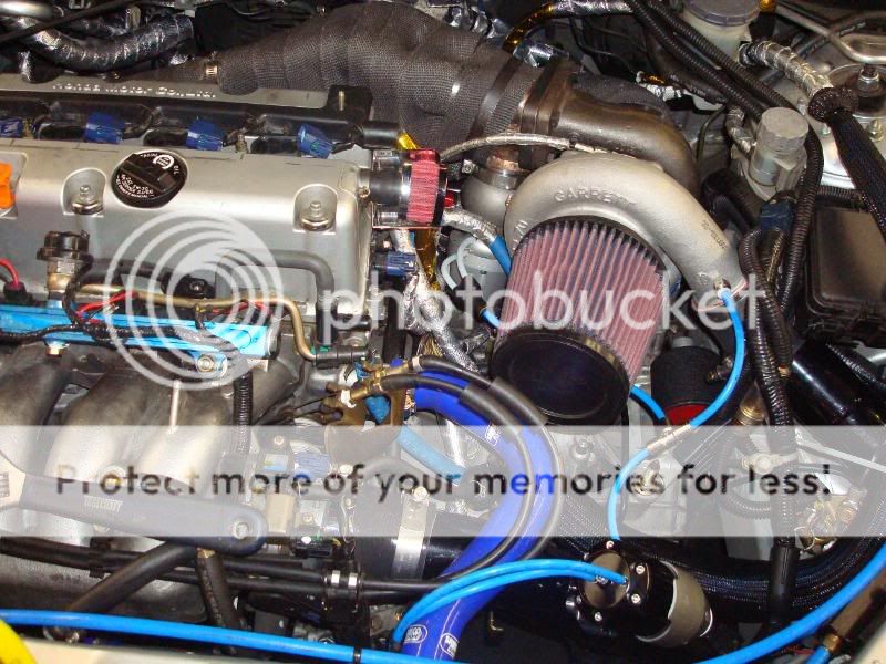

Ok, so I've been looking at converting my boost lines to the hard plastic Polyurethane hose like pictured below on this K20 Motor:

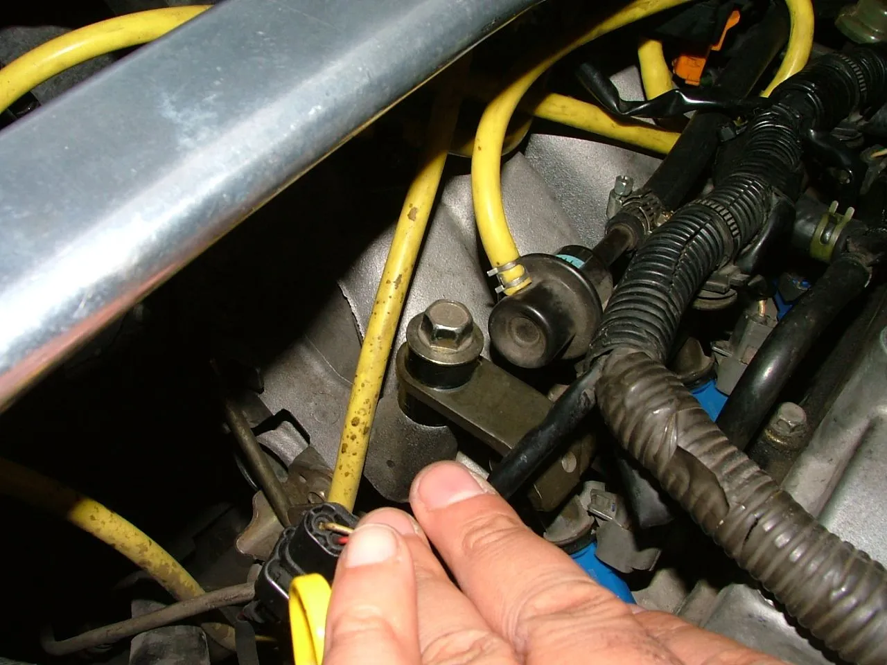

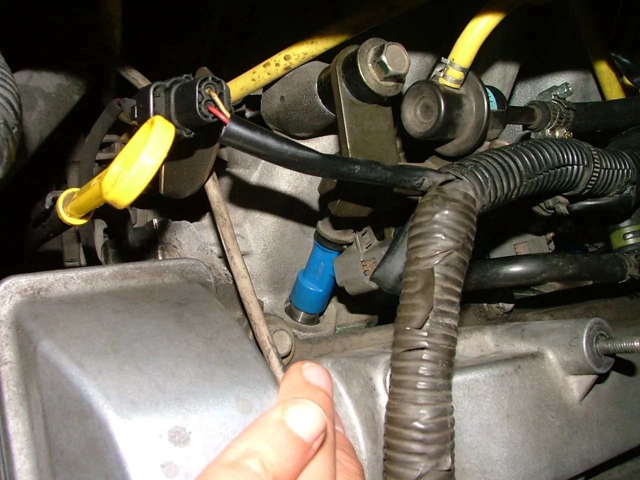

So today I pulled out my old RX-7 460cc S5 non-turbo injectors, and replaced them with the dark blue, 2007 565cc WRX injectors. Since I haven't seen my original fuel rail bolts, I had to rig up something a little special with the injector spacers to accommodate the longer bolt I had to use before:
Every since I changed out the injectors, I haven't had the infamous ignition pop when turning the key to ACC. No more 20 PSI spikes, before even turning the engine on.
